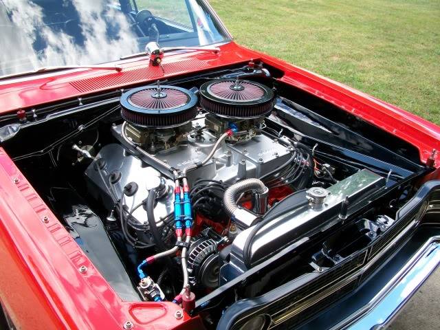

A question if you don't mind. How does the large alternator pulley work at low speeds or idle? Does it charge well?
doens't really affect the dart much, but it idle's at about 1200rpm and doesn't usually spend much time there. i'd shy away from it on a street only car. i was having alot of trouble with fan belts when the car had a 4 speed. that helped.
Yes, I knew that was the main reason for the large pulley...to help keep the belt on. Thanks. I didn't know if maybe you had solved the low RPM voltage malady or not....I guess at 1200 RPM it don't matter much. lol

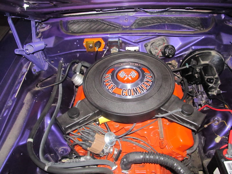

I have a Sb that i use Factory Electronic Dist on it, I have an accel coil and it has a roller cam and 4 barrel, it seems to do the job well enough.. I would think that a factory electronic dist would work just as well on a 360. I have another 318 that i intend on putting the same system on it for my car while this one gos in for some upgrades and i think it will do fine, its just a stock engine with EFI im putting a LD340 intake on so stock more/less..
68 HEMI GTS Thats a beautiful car, nice setup!
