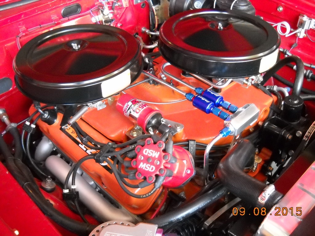

Hi Team B Body,
Its been a wet winter down here in Australia and good moments to get the coronet out have been rare. I have a 68 coronet with plugs that were fouling too often. after having a close call with the cops after a fast start at the lights to avoid stalling, I went down and got myself a MSD ignition box and coil. happily installed and working as per the MSD test. I can't seem to get any fire at the distributor. There is spark from the coil to distributor wire on test. but the distributor is not passing it on. I have ordered a new distributor but really out of my depth in replacing that (inc tools). Is there any tests you recommend before pulling the existing stock distributor?

Might be a silly, Capt Obvious comment, but how's the reluctor gap in the distributor? 0.007-0.010?
Don't ask me how I know this ... make sure you put the rotor back on.
How old is your cap and rotor? Contacts might be worn... Also how are you checking spark to the plugs?
So do you have a hot spark out of the coil through the coil wire to the distributor center tower or not?
Is the spark from the coil at steady intervals to indicate the reluctor or points are functioning when cranking?
The rotor and cap link the coil spark to the cylinders. A bad coil wire, wet plug wires, wet or carbon tracked distributor cap, or severely worn rotor can cause weak spark, intermittent spark, and plug fouling.
Thanks for the advice here gentleman, this gives me plenty to work with and check on. Rotor is definitely on. But age of cap and rotor are an unknown. I have new ones being shipped, so will check each out. I definately have spark through the coil wire. And the connection to msd to distributor look to be correct. The reluctor gap looks to be bigger than 440beep suggested, I will look up how to adjust that. Thanks and will update you all soon

if you have solid spark out of the coil wire but not on the plug wires then you either have a missing or damaged rotor dead short in the cap. Changing all the wiring in the world will not help if the coil is already firing and it just isn't getting to the plugs. Check the cap for carbon tracking . I am not familiar with what cap and rotor you are using but the rotor should have a metal tang that touches on the coil terminal and extends to the tip of the rotor to send spark to the plug terminals.
Ok, so in the end it was my distributor but I can't put my finger on exactly what was causing the issue, I hook up the MSD box through to the distributor when I take it out and spin it by hand and it sets off the coil to distributor wire sparking like it should, but not consistently like it fails also. Put the new distributor in and happy days.
