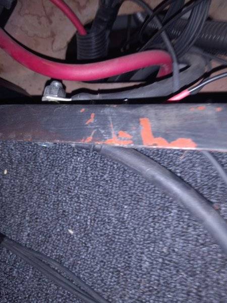

make sure all grounds are good. i have the mini starter and it very close to the block and no problems there. if so it would arc hard and show the short to ground so on to the other possibility the starter relay make sure if you are using a starter relay test voltage at the solenoid going to starter then at the starter and se what that show's
there have been many new cars with grounds to a painted surface that i have had to grind to bare mettle all grounds .
battery to body / body to engine / engine to fire wall . no such thing as to many grounds for electronic fuel inj,

From looking around the battery, cab,
engine, and chassis, there are no
ground straps. Methinks this could
be the cause.

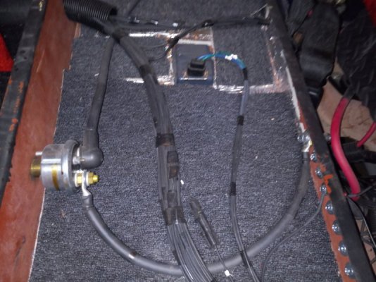

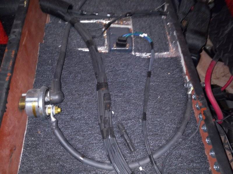

I checked for a ground from battery
to engine. There is one there. Didn't
see it right off until I lit things up.
The ground runs from the cut-off
switch to a bolt on the bellhousing.
I would assume this set up would also ground the battery to the body.

Battery is behind the seat. Has a good
body to engine ground.
