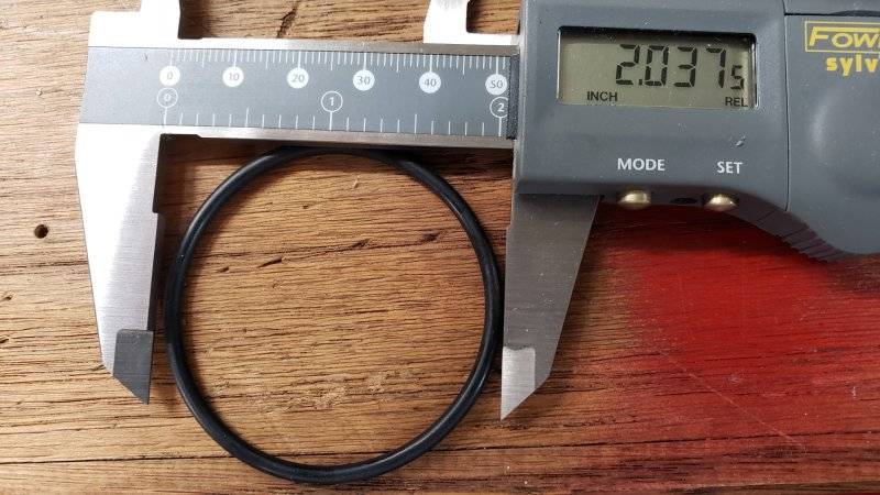

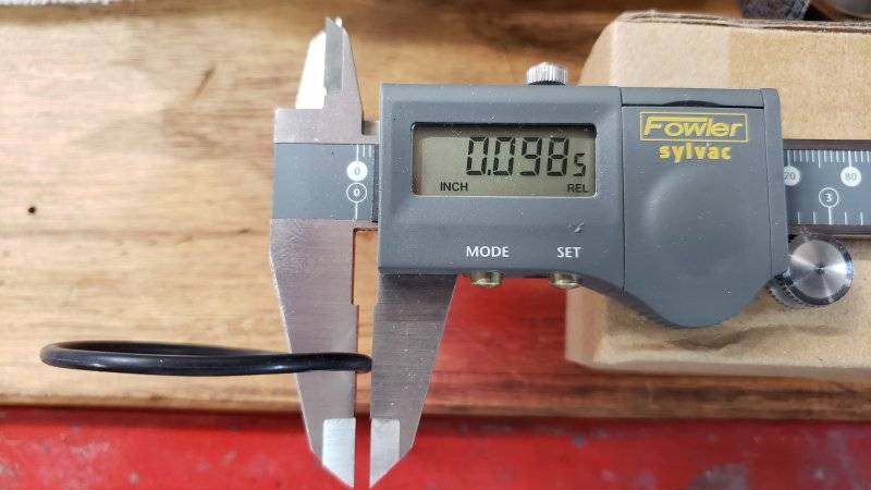

Hi fellas, can anyone give me the thickness and OD of the distributor O-ring used with all the V-8 electronic distributors? I'm looking for a part that does not cost $15.00! Thanks.
Mike
I measure 2.040 O.D on the O-ring and 0.0985 Dia.
