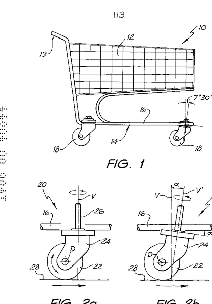

            The shopping carts pivot point projected to the ground, hits it in front of the wheel where it meets the ground. Same as the motorcycle, bicycle, office chair. they all have positive caster.
          • KENTON
            KENTON Well-Known Member
            Messages:
            669
            Likes Received:
            694
            Joined:
            Feb 25, 2014
            Location:
            chicken coop
            Local Time:
            8:42 AM
            C = caster

                  Motorcycle, bicycles - positive caster.
                  Shopping carts, dolly casters - negative caster.

                    I think the castor depends on whether the cart is being pushed, or pulled backward.
