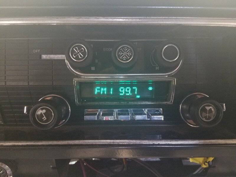

I was supposed to get you a pic, sorry got neck deep trying to get mine finished.
Anyway here is the unit, infinite colors and sounds great. Now I only had the two 3.5" speakers in the center dash slot wired and they blew me away with just the power supplied by the head unit.
Getting back to the speakers they are 3.5" Kicker CS series...incredible sound and even had bass which surprised me. Cant wait to fire up the 6.5 and 6x9s.
