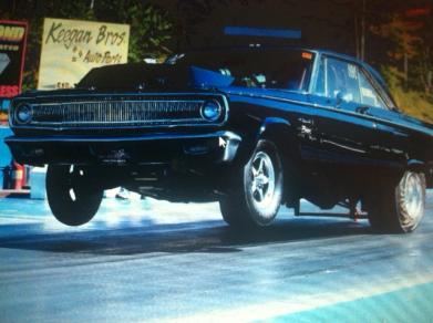

that's a bad *** black duster in that pic. :icon_jokercolor:
