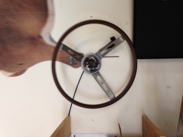

Does anyone know what this might go to? Steering wheel photo ID

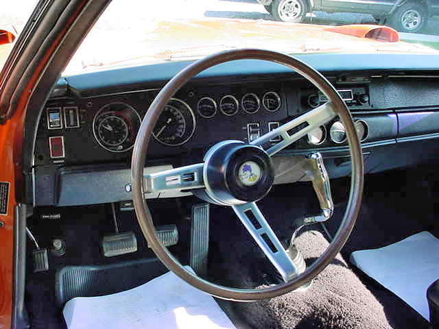

Try 69/70 b-body !

So there are no issues with using it on my 69 Superbee? My black Wheel was cracked and crappy.
Do you have the correct collar that goes with it ? The wheel will fit,you will need a 69 collar ,the 70 is larger at the bottom,it will fit but is larger diameter than the top housing on the column.
I've seen these steering wheels in 67-69 Barracudas and 68-70 B-bodies. Emblem in center of horn pad is different on various models.
