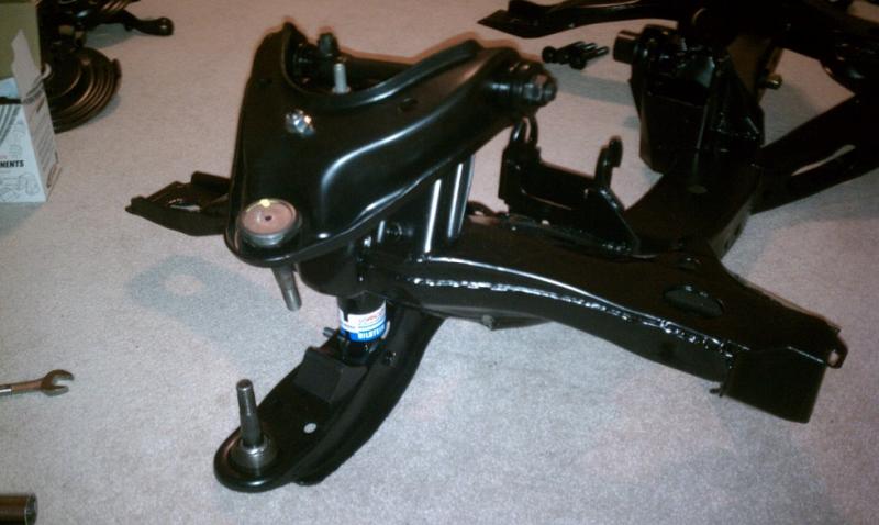

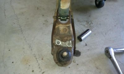

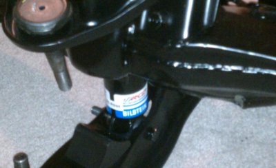

I'm not sure what you mean if the issue has been corrected. As I said originally, I had to modify the lower control arm opening because the Bilstein shock tubes are much wider than original shocks, so in order for it to not hit the lower control arm and bolt up properly, I had to widen the opening on the LCA.

So, to my knowledge the Bilsteins are wider tube to provide more damping action than a standard shock, the factory ones were pretty small by comparison. I don't know if they have changed their specifications, but maybe someone that has recently purchased may know, as I did my suspension 3 years ago.

I to am interested, in how big the tubes are. How much modification is required? A little grinding or cut off wheel ?
If were talking grinding then that's no big deal I dont want to cut on the control arm
I wish I had better pictures, but you just need to grind a bit off the inside of the hole in order for the shock to fit in from underneath. If I recall I had to do about 1/16 of an inch on each side or just a bit more, 3/32.
As you can see in the picture below of the original, the tube is pretty small.
Now here is the view of the Bilstein, sorry, don't have a better picture, you can tell its much bigger.
Thank you very much idrivremopar that's exactly what I needed to know 100% opp be ordering my suspension stuff soon thanks again
