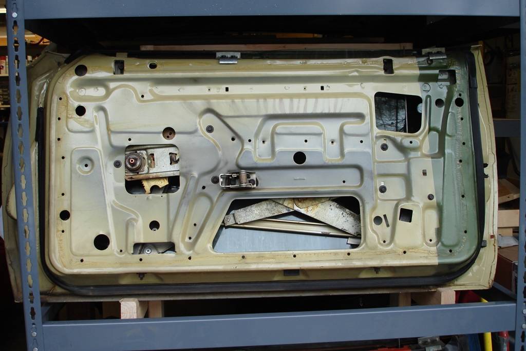

Let me clarify, yes, i know how to make a new vapor barier, and i have the strip caulk to attach it, i need to see an existing one as i would like a visual reference as to where the edges are, and the shape of the plastic and the location of the strip caulk. This is why i would like to see a picture of a door with the plastic still in place if anyone has one.

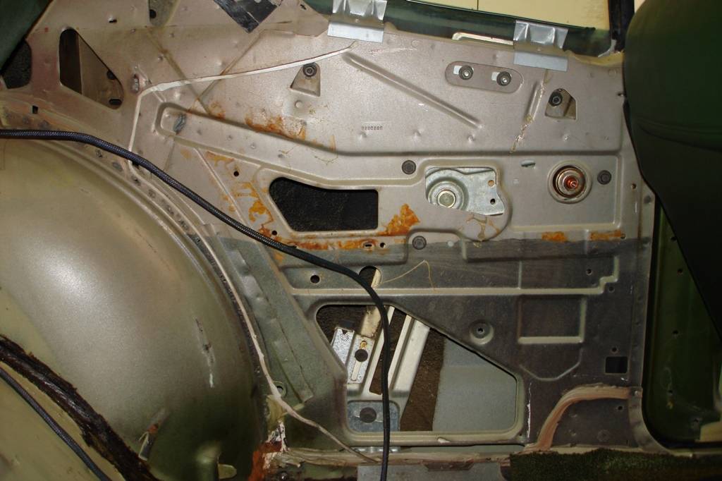

For ’72 anyway, no strip caulk on the doors, a brush applied contact adhesive was used originally. The quarters have a strip caulk like material holding the vapor barrier in place. I reassemble with new material and strip caulk in the rears and normally used spay adhesive for the doors. On my recent RR/GTX resto, I had some BMW self-adhesive, heat shrinkable vapor barrier, left over from a previous project, I used for the doors.
Thanks! That is a tremendous help to see the marks where the contact adhesive goes, roughly! I had the barrier still in tact for the rear panels, so i am good to go there. Anyone else with any pictures!
