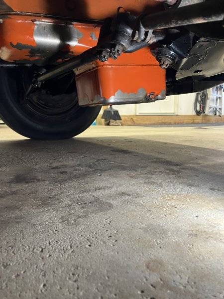

Does this look like higher capacity pan?
Bleep Bleep
12:24 PM
Aug 4, 2024
509
714
Pittsburgh
‘66 Hemi Satellite. First change. No ownership history or docs.
Service manual is 5 qts incl filter. I took between and 7-8 QTs out and was reading at the fill line (maybe another qt to be full)? =8-9?
Does the pan look aftermarket higher capacity?
Thanks!

That looks to be about a 7-8qt pan (+filter). I'd run 7qts, including filter. I would absolutely ignore the fill line on the dipstick.
The advantage of a deep pan is more capacity, and the oil can be farther away from the crank. Less windage, less power loss.
The disadvantage? Speed bumps.

Crowned roads also. I took out a deep pan on my '64 actually stopped the car and dug into the road. It was a Hamburger's Oil pan which lives on now in my friends 68 Charger..
