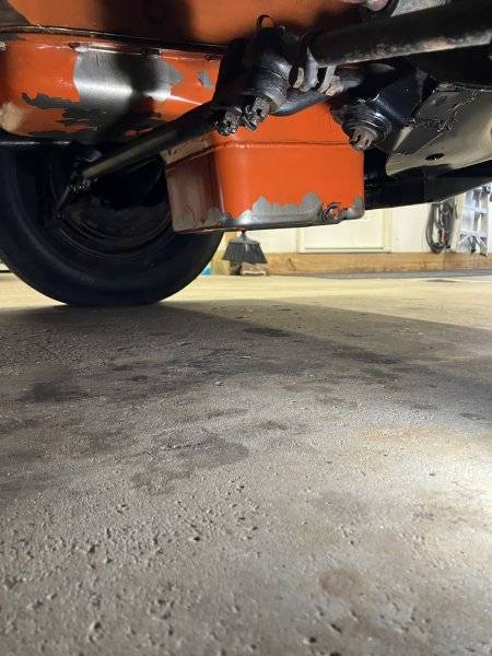

Have a buddy that went over a rise in the road doing 45 and scraped the pan on the other side of the rise. It was one of those deals where you wouldn't think it would happen. The scrape made the pan leak like one drip per second.....at least he was able to get it home.
It’s a street car now. Prob has been its whole life but I have no history unfortunately.Is this a street car or drag car. Down side for a street car with a deep pan is hitting something like a dip or road hump. Gotta be careful with them.
Yeah, not knowing any better I wondered if that might be a factor also. But, if the xtra capacity is simply deeper from stock wouldn’t the stick still read from the same as stock pan level. Full is full, just more volume to get get the same full level?Before you go running less oil than the dipstick calls for you should verify that a longer oil pickup tube was also installed.
The deeper the sump, the higher the ride height needs to be.Good point. Conceptually thinking of changing the rake (slightly - maybe a couple inches). In addition to swapping the 14s for 15s.
Ok. That’s just about where it is now - if the dip stick is correct.I'd run that pan at least a quart low on the dipstick, maybe more.
Came with a SunPro gauge that’s reading about 75 lbs at normal idle. Soon going to replace it so I have more confidence what I’ve got. Mechanical was the way I intended. Thanks for the reinforcement.(And for peace of mind, a mechanical oil pressure gauge, to look for loss of oil pressure under hard acceleration or braking.
AMEN!Any swap trom 14s to 15s is a good thing.
Then you have the idiots that don't slow down no matter what!If your ride height is high in front that helps a lot.
Just be careful with parking lot speed bumps. They seemed to have gotten aggressively higher and increased use over the years trying to slow down idiots.
Hopefully, the oil pickup is already down in the bottom of the pan. One way to find out is to drain the oil, then drop in 2 quarts. I like to remove the spark plugs when doing this.....watch the mechanical oil gauge while using the starter. If the pickup tube isn't deep enough, you will see it on the gauge pretty quick. A high volume pump will show up even faster.Before you go running less oil than the dipstick calls for you should verify that a longer oil pickup tube was also installed.
It’s been cold here since the car was delivered. Yesterday changed the black coffee oil for new 10/40. I had purposefully not ran it much until having fresh oil. But today ran it altogether about an hour - flushing coolant. The psi settled at 45 which feels a lot better range.I had a higher than I liked oil pressure with 20w40w oil. Went to a 10w30w and it's much better.
Thanks. Thats right where I’m at. Contemplating whether actually I’ll keep the deeper pan, and if there’s any advantage given I’ll never race it.I was shopping summit for an oil pan for my Opel, and ran across a pan that looked an awful lot like yours. Specs said it was a 7+1 pan.
