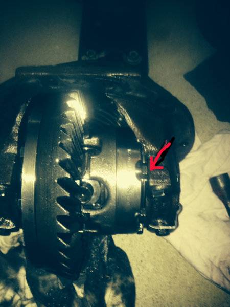

The used 3.91 we installed a few years back started clicking real bad. We haven't put but a couple of thousand, albeit hard miles on it. We know very little about rear ends and even less about Sure Grips but we noticed all the bolts of the right side of the unit were backed out and sloppy. See photo. The ones that would be parallel to the axle. I don't know if they are sheared off or just backed out. Can we just unbolt the unit from its carrier and tighten or get new bolts? Any info will be helpful. Sorry for the night time picture.

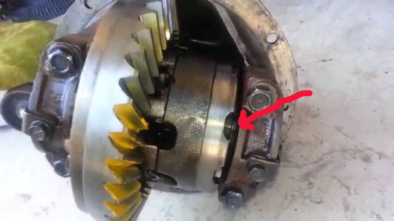

Here's a better picture off the internet showing them tight. You can click all of them and get a bigger pic.
Those need to be torqued to 50 ftlbs. Use some blue loctite and you’ll be good.
View attachment 614508 View attachment 614512
Yes mark the bearing adjusters(the round threaded wheel things on each side of the unit)and case with a punch and note exactly how many threads are showing, so it can go back in exactly the same position(that's your bearing side-play adjustment). Then just unbolt the two retaining caps and two locks and the unit will come out of the carrier, and you can replace the bolts as needed, and torque as 5.7 noted in his post above. Torque the bearing cap bolts to 90 and the locks to 20 lbs/ft
OH.. while you're there, look in at the spider gears and pinion bearing and make sure there's no damage...look for metal chunks in the carrier or housing before you put it back together and you'll be off and running
......….I don't know if they are sheared off or just backed out...…...

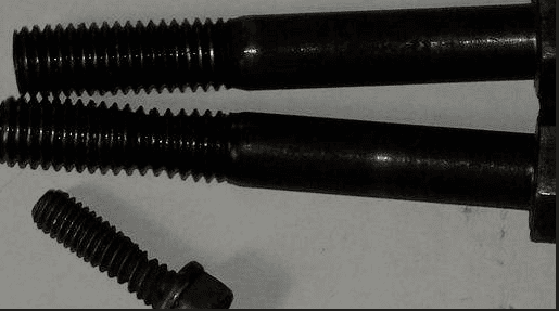

There's also a remote possibility they have been over torqued and stretched or not even torqued at all. Inspect them carefully.
Example of stretched from the net...………..
