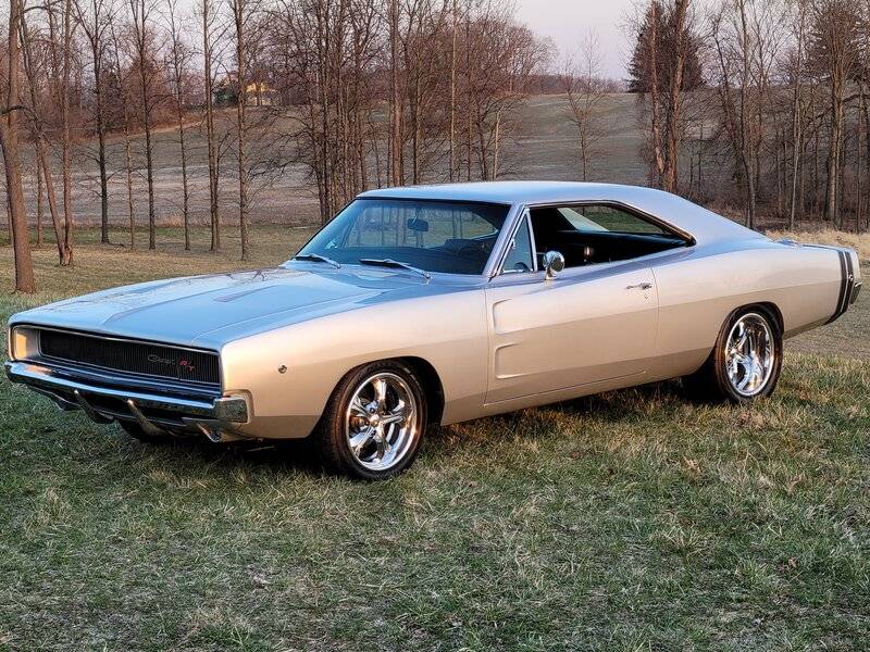

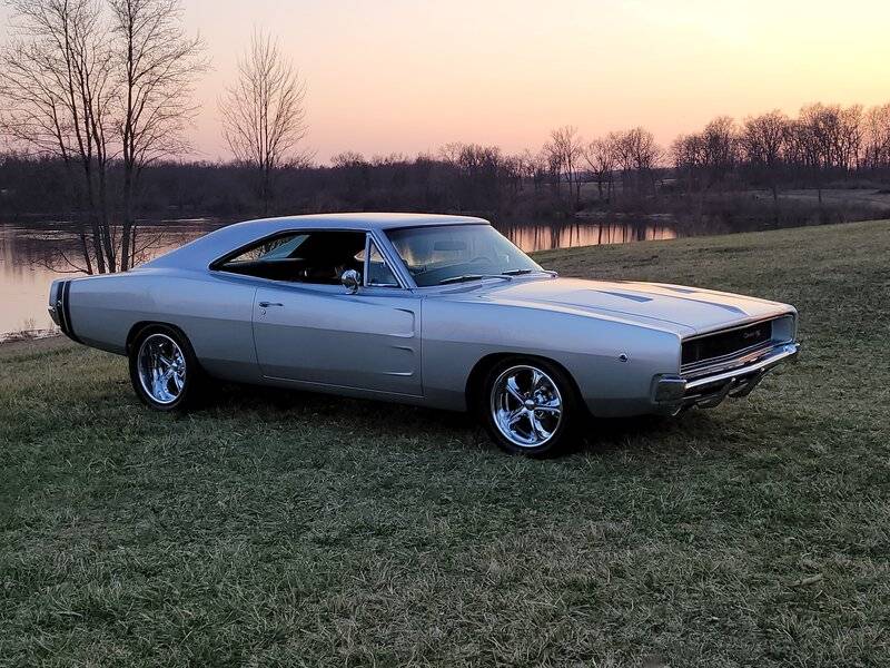

well putting her away till spring, she needs a front end alignment and a few other tweaks.took this shot looked too good.

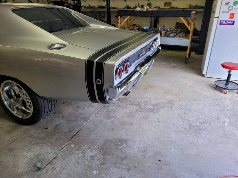

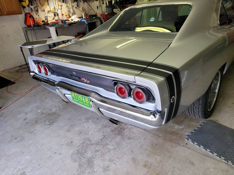

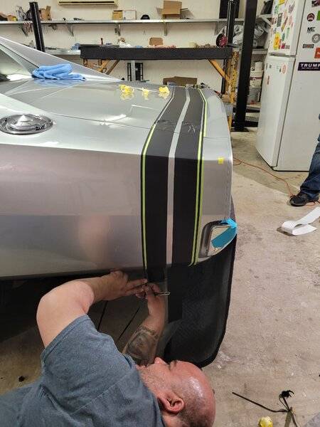

changed out the rear stripes on the 68 were at an angle to the quarter caps, drove me nuts, took R.C's advise and wrapped the tail panel also, You were right looks way better:lowdown:. my son in law wraps cars, busses trailers etc. for a living he printed up some stripes and basically put them on one by one using 1/4" and 3/4" tape for spacing, the off color kind of looks cool. trailered it down to my lake property to test and tune roads are terrible around my home, different county. fuel injection work very well starts right up at any temp, seems like its lacking a few h.p. going to turn up the fuel pressure a few points and double check afr ratio's ordering an electric dual fan for the griffen radiator today running slightly warm, about 199 to 203 and its only 70 out. wanna remove the widow maker flex fan anyways since I've seen some of the carnage those things can leave. went that route since I couldn't get the clutch fan to fit, either
to close to the radiator or fan hit power steering pulley :mad:.
thank's I gave it my all, been messing with cars since I don't know when. wanted to do one off the charts, well at least I tried.:lol:
