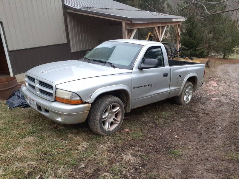

When this was offered to me for $500 I couldn't pass it up, looks like the daughter's 72 Satty is getting a 360 with overdrive. I'd love to fix the truck because they're badass haulers but it sat in a yard for years and would need a complete donor truck to even be feasible so donor it is. I knew I wanted EFI and OD for her so for $500 I got it all, I'll freshen up the 100,000 mile 360 and replace the tranny seals and filter and call it good.

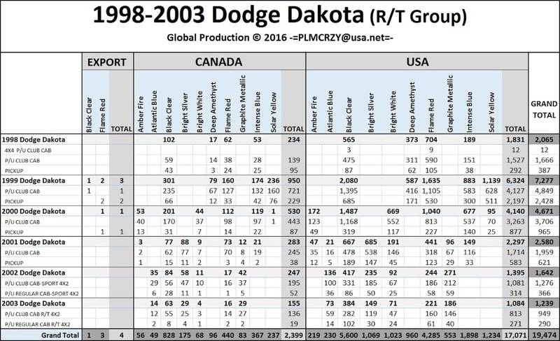

You might want to hang on to that silver r/t it has pretty low production numbers.

I have had several 2 black club cabs 1 Deep Amethyst they are pretty cool little trucks. The silver ones are low production colors. I think only slightly higher than the rare white RT trucks.
I have one of the 163 2000 Amber Fire club cabs.
It's bad, frame has rust pushing parts apart, missing driver side inner fender rotted the cab pretty bad, bed is shot.... like I said to fix it I would basically be transferring the drivetrain into another truck.
Well damn that sucks... Didnt realize it was that bad off. In the pictures it doesn't look bad..
It's pretty deceiving, when he first offered it I was excited then I looked it over:eek:.

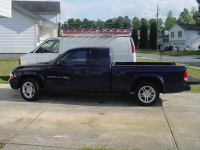

Here is my old truck
