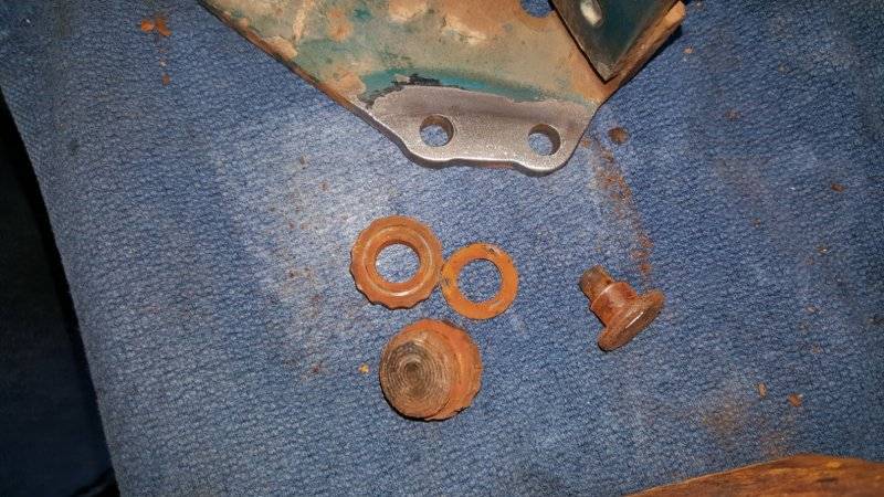

The only thing I could not get to rebuild my hinges where the plastic parts that hold the door open. The rest is sold in a lot of places.
There is no good replacements, they use that cheap Chinese metal nowadays. I would get yours rebuilt if you still have them by @MoparLeo
Rick's parts kit is better than most but only addresses 1/2 the hinge problems and assumes you need a double oversized pin. You may only need a 3/8" pin.
There are no plastic parts on 66-70 B-body hinges.

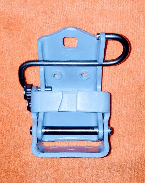

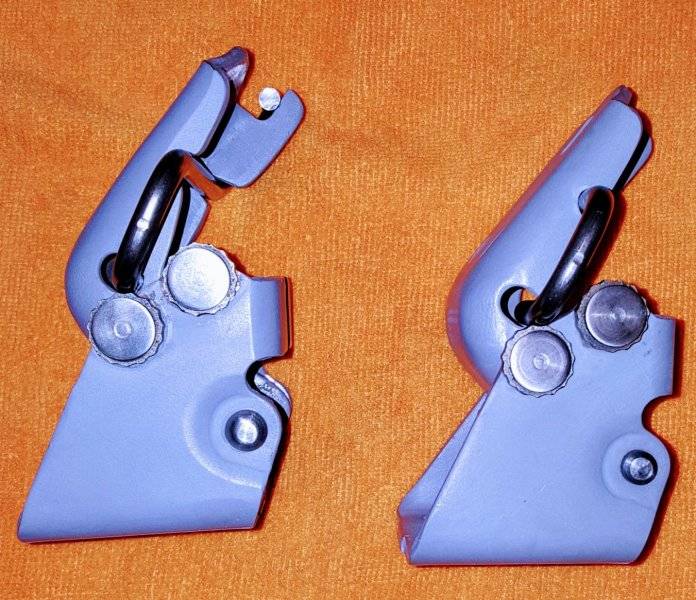

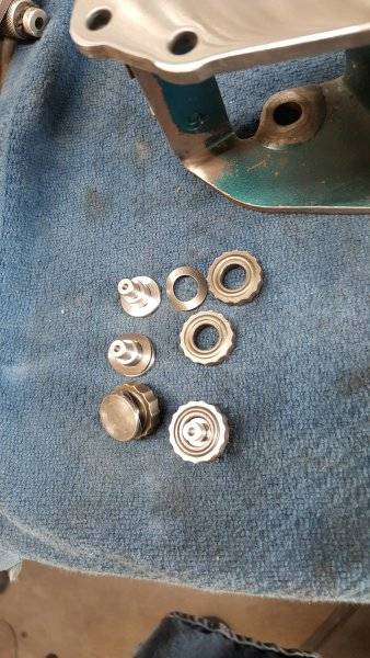

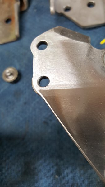

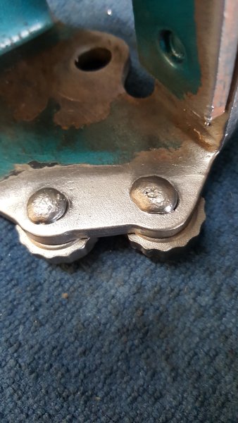

You cannot buy all the parts we install. The door check roller pins are custom made as well as the springs and custom sized pins we use.
Here are some pictures and member price sheet. We do many members and Mopar restoration shops hinges.
