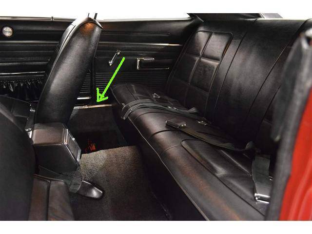

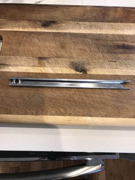

Can anybody show me a picture of how this piece of trim goes I have no reference.
It looks like the short piece that fits under the back of the main door sill trim and holds down the carpet under the rear seat side window panel.
Yes that’s what I figure but I don’t know how it goes. Does it go under the door panel in the rear or sits on top? That’s why I was hoping to get a picture
OK thank you I’m guessing it just lays up onto the back door panel and bolts the floor underneath the seat
The slotted end of the part slides under the back of the main door sill plate, and around the rearmost screw. Then, tighten the screw. Press up against the quarter panel trim, and set the rearward screw - there should be a hole in the floorboard for it. If you have new floors, I can take a measurement for you - I have the interior out of my '70 right now so it's all easy to get to.
Thank you. I was able to get them in how I think they should be in I appreciate all the help
