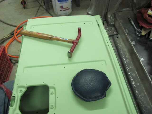

Door skin crimp tool, anybody used one
I saw a small shotbag being used on another forum instead of a puck dolly.
And a skin hammer also.
Seems a good solution too.

The steck skinner is garbage !! If you like repairing a new panel all the way around the hem flange it is all you. After 25 years in the collision industry the only tool that is fail safe to doing door skins properly is a quality body hammer and hockey puck. The shark door skinner works well,but requires hammer and dolly work to finish in areas.All these tools require you to start the repair in some way with hammer and dolly. Trust me if there is a tool to make the job easier or quicker I will own it!!! Save your money! If you are looking for good quality hammers try dagger tools,stream line,and snap on are my favorites.
Thank you for your input, Moparpoor, as a matter of fact since I had not seen any posts from anyone with an opinion except it looks cool until now, I went and ordered a Martin Skin hammer and rubber dolly. I found a reasonable price on ebag for the set. While I was at it I ordered some additional hammers that I did not have.
One comment I read somewhere was that the Steck tool would follow the frame of the door, I felt that was a true asumption. the problem with the skins on our doors is that the skin is larger than the frame and the tool with the air hammer may end up pushing in too much on the door edge and make waves.
thanks everyone for your inputs, I guess oldschool is the best.

I use the exact hammer as above post. I found with the shot bag it is hard to hold sharp body lines and keep them crisp. The hockey puck is hard enough to hold the shape without out damaging the skin.
