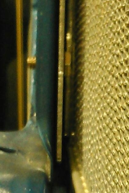

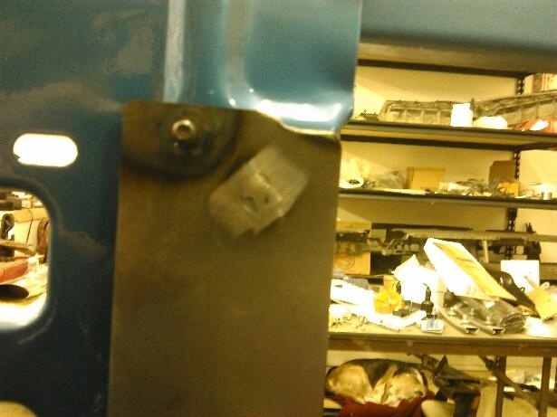

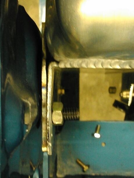

So got the brackets finished up. I decided to drill out the threaded blocks on the drivers side so I could weld studs in the brackets to keep everything pulled in tight & flush. I drilled the threaded holes out to .257 (F drill bit) so if I wanted to tap the hole I could do so at 5/16. A flange nut makes a good tool for holding bolts square while welding.

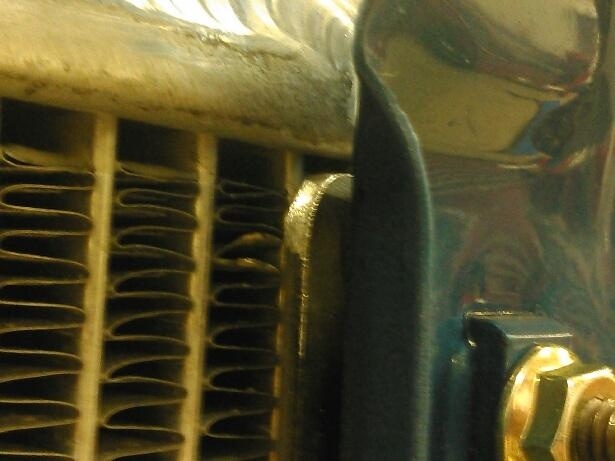

I had to clearance the top a little to make sure it wouldn't rub on the tank.
so here's before, and after.
The passenger side bolt heads clear so I just used the stock threaded holes for the bracket.
Drivers side with nuts on the studs,

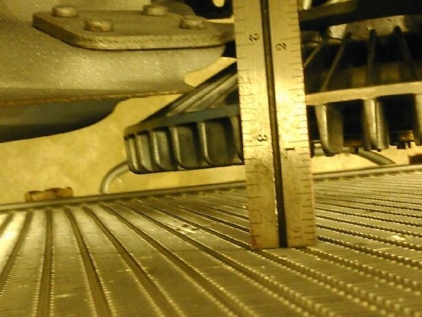

Final clearance at fan clutch was right at 11/16 or about .810, just right.
