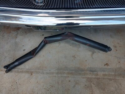

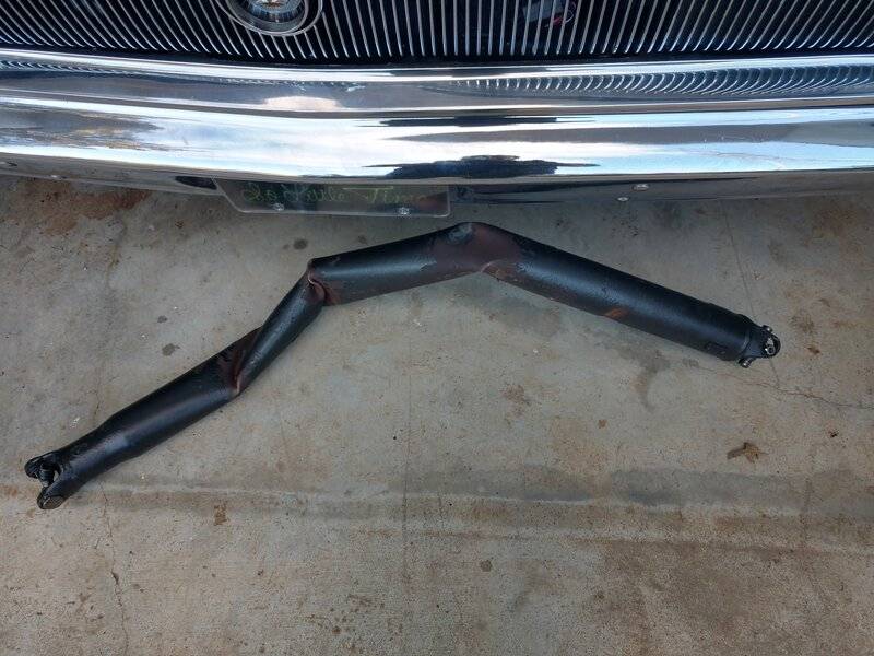

until I twisted the drive shaft out of my car on the chassis dyno
Destroyed the custom exhaust too

My twisted drive shaft was the result of a U-joint failure
I went with the Strange Engineering Driveshaft as recommended by Doctor Diff

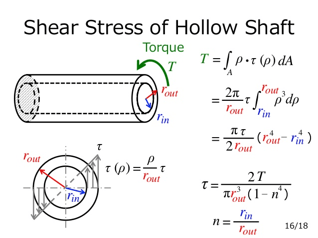

The equation for the torque capacity of a driveshaft has D^4 in there. So doubling diameter = 16x torque capacity. Diameter matters. Just how much each of those listed can handle, when 50 years old, I’m not going to calculate but if you are doing much more than stock go bigger. The 3”, if the wall is the same thickness, can handle 2x the torque of the 2.5”.

I believe the terminology you are searching for, deal with the section modulus which as you note is a function of
OD + the wall thickness which affects the moment of inertia of assembly. And yes. Its an area function.

Exactly. For this forum I thought the actual math less important than the concept.

I broke mine on the starting line, pretty sure the u-joint broke first. I've seen others break at the start.
From what i have seen, a failure on a starting line is usually u-joint related. When a driveshaft turns into a pretzel, its usually a critical speed failure on a chassis dyno. (Cars can reach high gear or overdrive speeds on a chassis dyno they could never reach on a highway). That could be a result of a bad u-joint being over-speeded too.
