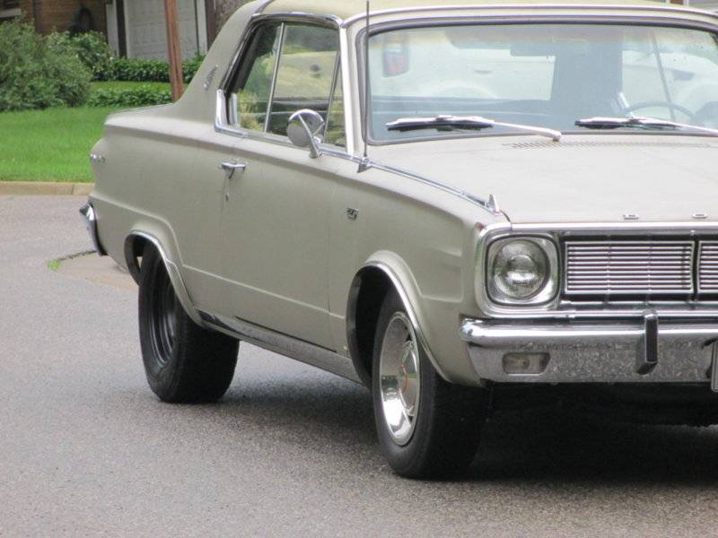

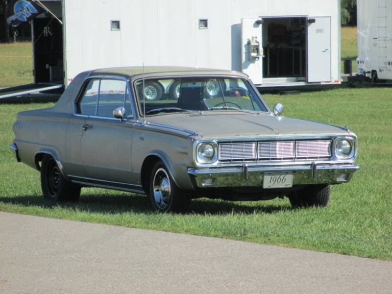

Dual mirrors look good but the right one is pretty decorative and not too functional. I put one on my 66 Dart and it helps a little to see what's behind you on that side.
