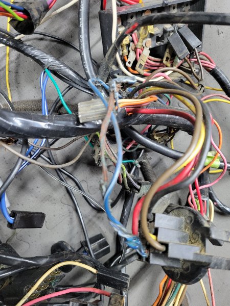

I agree, this dash harness came out of my running '69 Road Runner when I bought it. It is I believe an old race car, the front had all been hand wired and hacked. Ordered all new M&H wiring harnesses. No idea how long that wire had been hot and overloaded. It was like that all the way to the bulkhead connector. I have yet to drive the car, so the burned wire happened before my ownership. Believe it goes out to the ballast resister.
