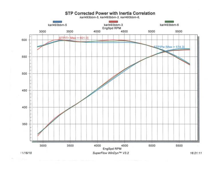

Results are in for my new motor. Started with a running and driving 440 6bbl with unknown internals. My instructions to the machine shop was to put together a 500inch stroker motor that maintained the 6bbl set up, and stock manifolds. The motor needed to be pump gas friendly and look stock when put back together. The shop did not disappoint! 574hp and 601ft/lbs torque. I don't have all the details of the engine internals with me, I know Edelbrock performer heads, full roller cam/rockers (I don't have cam specs handy). I did add a Hughes 2800rpm torque converter and the am currently running a Dana 60 with 4.10 gears. With all the torque I have now down low, I am thinking something like a 3.08 gear will me the next change.
Motor is in the car, but not yet fully buttoned up. Apparently my new motor mounts are a small bit taller than the original ones. A little clearance work will need to be done to the hood to get it to clear (A-12 style lift off hood).

Did they dyno with the exhaust manifolds on?

I’d love to know a few things, so, when you find out what the cam specs (card/grind number from who was used), compression, exhaust set up tested & if any head work was done, I’d be set grateful on that information.

Cam is a comp thumper hyd roller 23-602-9.
Motor was dyno'd with shop headers on it (not the manifolds I plan to run.)
According to shop, they planned to run the heads out of the box.
Not sure what final compression is, I have to go back to the shop tomorrow and will ask. I told them the motor needed to be pump gas friendly, and they tell me it is, so it wont be too extreme.
Comp Cams 23-602-9
243/[email protected], 107lsa

I've never understood the point of placing an engine on the dyno with different headers than will be on the car. On a big-inch Wedge, it could mean a 550 HP pull with dyno headers and open exhaust, versus a 475 HP pull with manifolds and restrictive mufflers. What gets me even more, is when a carburetor is tuned on the dyno for WOT with that dyno header.
