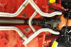

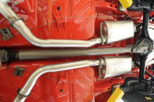

Here you go
max wedge e-brake extra brackets 1.jpg max wedge e-brake extra brackets 2.jpg
Brian Brady @ Crossram Connections should still have the brackets. Joe Suchy would be my next call.
Maxies came from the factory with 2 brackets per side, welded or bolted depending on make.

Agree remember mentioned in a thread? Look at Post #5 by teach, dumps are in middle of connectors. 3" h or x pipe no problem . Ad electric cutouts, vandan may not like the idea, his car. Picture 3" tti h-pipe on 65 Dodge Coronet, crossover pipe 2" wider, no tti headers.
