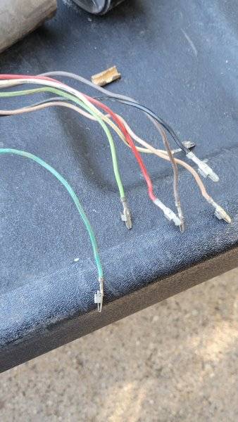

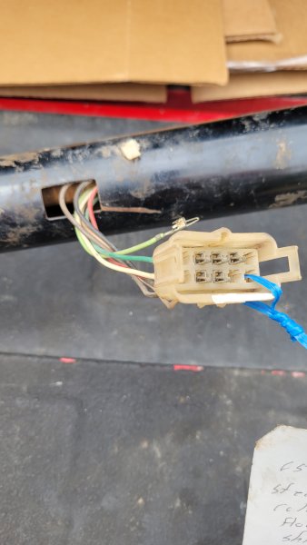

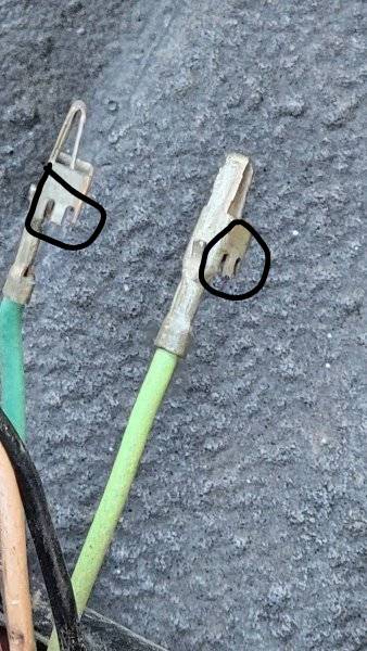

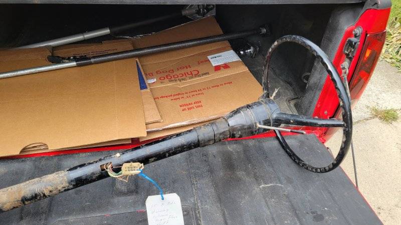

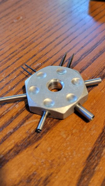

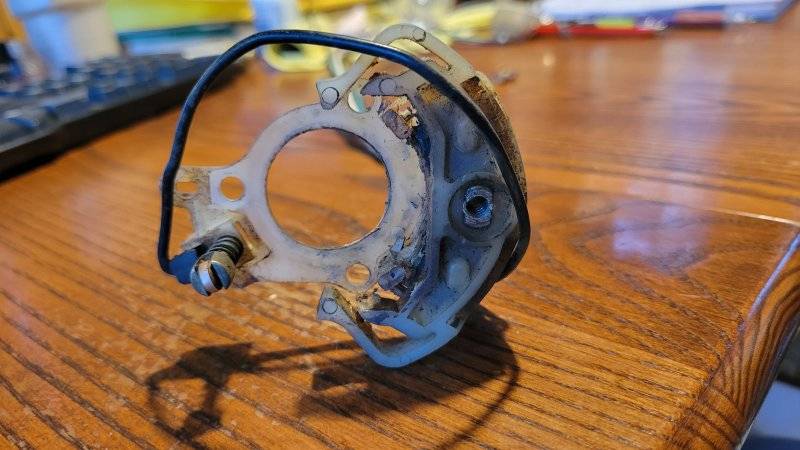

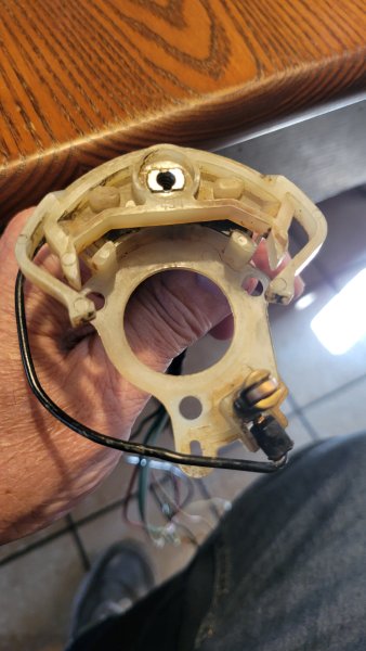

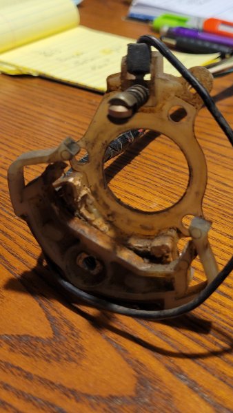

I did post this in another thread but it bears repeating. Here is another option. I was able to buy a whole column from a friend with a solid feeling oem switch in it. It was a turd to get the terminals released (another story) but the switch came out fairly easy and cleaned up nice. I will still get one from @Slantsixdan if he has some available.
