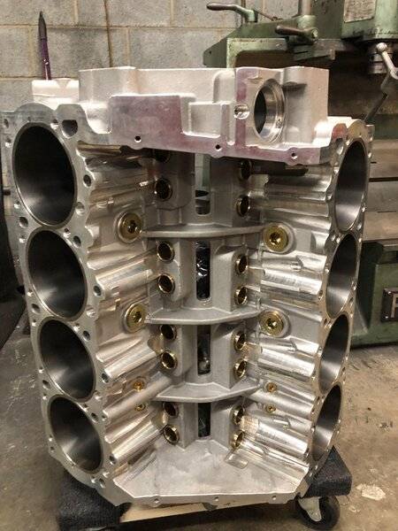

Any remaining doubt that it's lighter will be addressed when THIS:
aluminum block goes in, and the TrickFlow 270s replace the 452 iron heads.

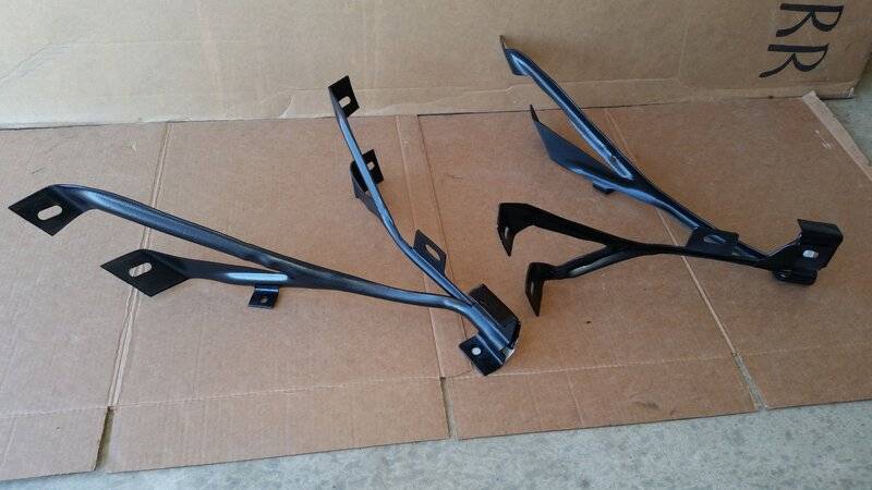

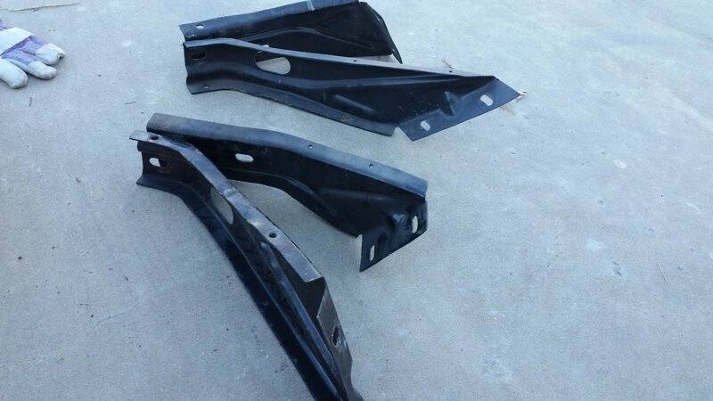

I don't know how much weight I saved on my 66 Coronet front bumper brackets but after I cut them down the new ones weighted almost nothing. Only good for fiber glass front bumper though.
