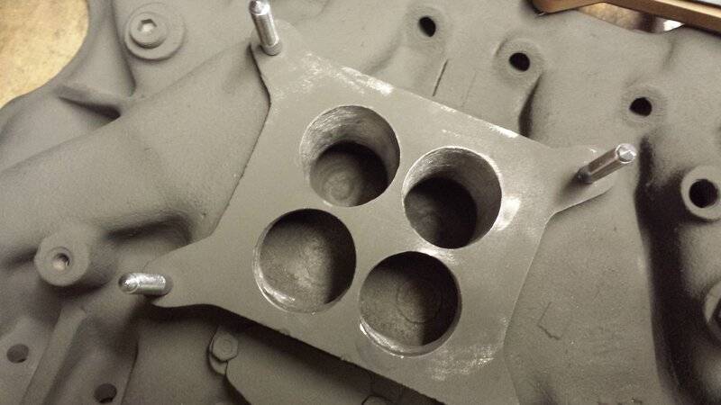

If I remember right you’ll need an adapter, stock manifold has the small square pattern like a WCFB I believe.
The factory 4bbl iron intakes yes... Same for the 2x4 factory set up --- the Weiand 7503 4bbl would accept a standard 4150 flange

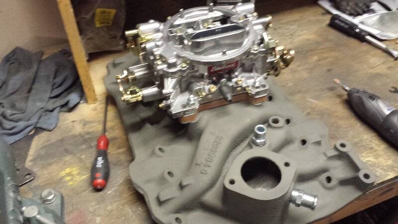

Made my own and opened up the manifold a bit.
