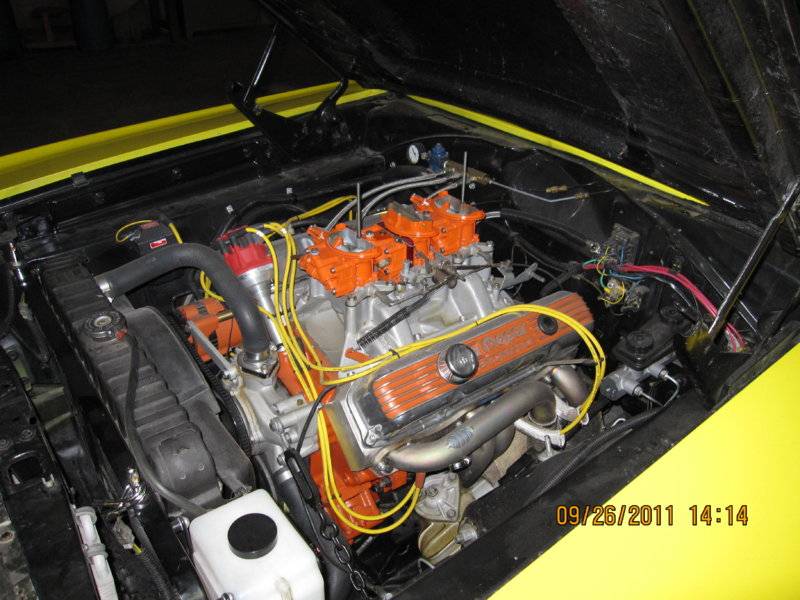

I bought a Ohio Crank assy, probably before 440 was in business. It works very well for me. I'm running a six pack, entire Hughes valve train, 10.6:1, manual valvebody TF, GV OD unit. 4.30:1 Sure grip. Pulled 452 HP on Steve Morris' chassis dyno. Mike
