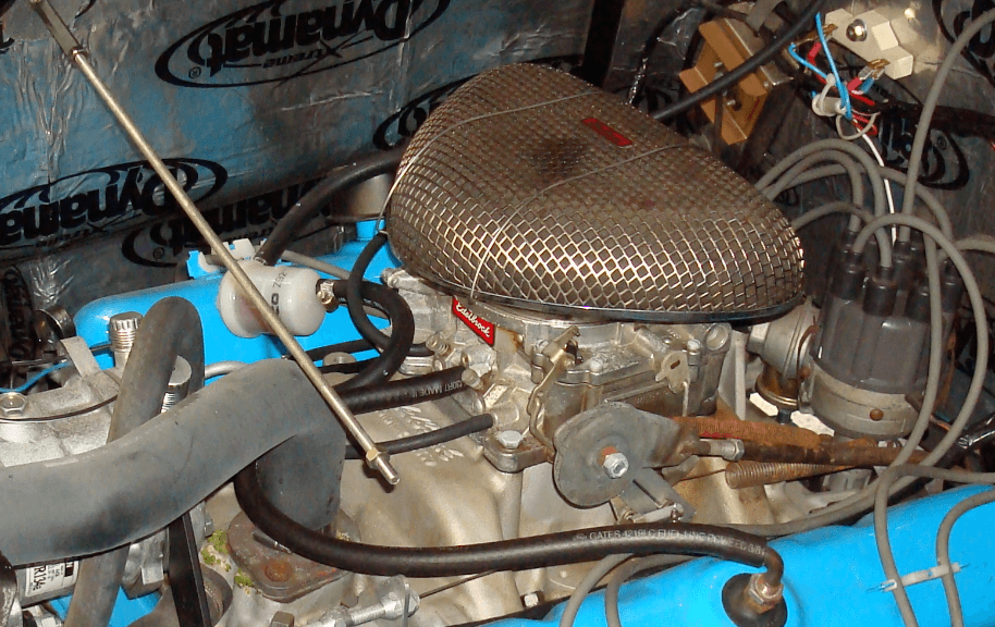

I run an Eddy on my A100 (toast rack gone now in favour of an unsilenced Dodge air cleaner. Seems to work fine for me.
