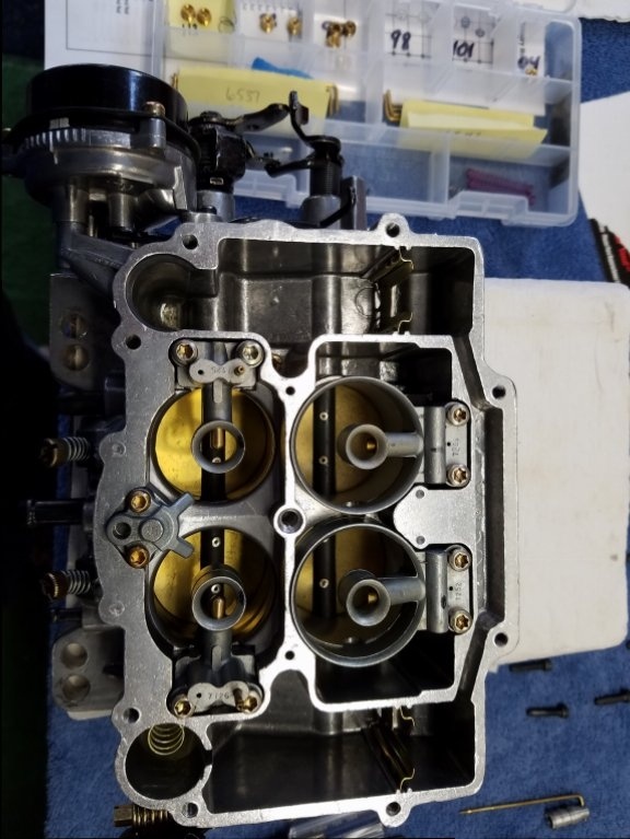

Edelbrocks can be temperamental, IMO especially on a modified engine. Look at the attached and notice the orientation of the baffles. They actually cover the rear jets, but if they are reversed they will interfere with float movement. Did someone mention this already? Pay particular attention to sediment also, if any. This is a new 800AVS 1813 with about 3 hrs run time , but it should still look pretty clean in there.
Edelbrocks can be temperamental, IMO especially on a modified engine. Look at the attached and notice the orientation of the baffles. They actually cover the rear jets, but if they are reversed they will interfere with float movement. Did someone mention this already? Pay particular attention to sediment also, if any. This is a new 800AVS 1813 with about 3 hrs run time , but it should still look pretty clean in there.View attachment 379901
Ya. Don't know if top will go on? He's not getting fuel into carb.
I don't think your getting any fuel into the bowls. Take the top off and set the float level EXACTLY as it says in the re build kit directions. Then hook a tube to the fuel inlet, blow thru it and see if it flows air. Then turn it upside down which closes the needle and seat, blow again and it should flow no air. You may also want to have someone familiar with those carbs help you figure it out. Carbs can be frustrating, but they are fixable.

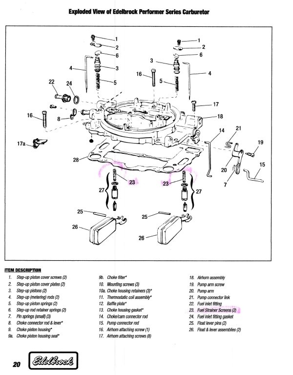

You did pull the old seats out and check if they had the small screens pushed in from the back side of the seat? Those screens plug up pretty quick if there is crap in the fuel system.
Doug
By "seats", do you mean jets? I replaced my metering rods and jets last summer to lean it down and I don't recall any screens in the jets.
I think he means seats for fuel inlet that the needle to floats ride in that let fuel into carb.
Yes, the screw in seats below the needles. Many have screens behind them. The system is very simple. Fuel is fed to the inlet, as fuel is consumed the float drops. The needle pulls down with the float. Fuel flows through the seat and around the needle. The bowl fills, the float rises and the needle seals against the seat shutting off the fuel into the bowl. This happens in various states depending on fuel demand from engine load.
Doug
On the original AVS carbs, yes there was a "strainer" behind the inlet fitting on the side of the carb. If this gets full of crud, you aren't going to get any fuel.
I'm not positive, but I believe the Edelbrock's have this inline "strainer" behind the inlet fitting also.
Edit: Just checked on the Edelbrock design, they are slightly different from the AVS. Instead of the "strainer" behind the inlet fitting on the side of the carb, the Edelbrock's have the strainer hidden under the needle "seat" which is screwed into the top portion of the carb. Unscrew the seats and the "strainers" should be accessable. There is one on each side.
