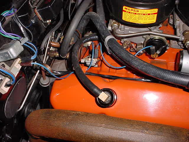

That's easy if your original choke assembly is complete.These carbs are the same as Hemi carbs,the electric choke is Carter,only thing to change is choke cap and spring.Find an intake mounted choke assist thermostat heater from a mid to late 70's ,wire it to the ballast resistor and you're done.The heater supplies heat to the choke spring,as the engine reaches operating temp the heat cuts off power to the choke coil spring.I had to go that route as the Max Wedge manifolds also have no prevision for heat.I may have another electric choke coil if you go that route.

My hemi has the original choke assy and all I did was add the electric element (black plastic part) and it works fine (like the pic above). As another option, when I had my 68 Mustang GT I drilled a hole through one of the header tubes and welded in a 5/16" stainless tube. Worked great!
