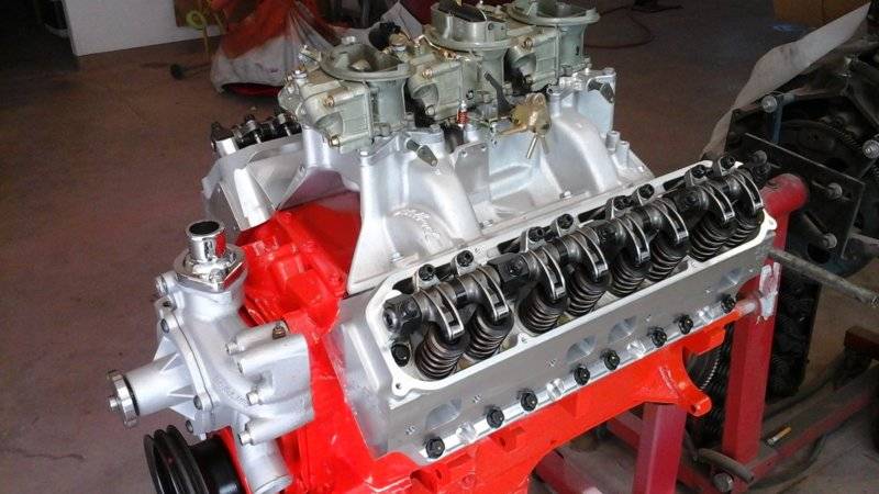

I built my 383/432 Stroker this past winter
Not a race motor , will never see the track
Street/Cruise
Been running it all summer with zero issues other then a needle and seat that backed out on my Carter AVS
That’s a interesting story
Anyways
Edelbrock E Street Heads 75cc
Comp Cams XE275HL Lifter Package
Comp Cams Magnum Pushrods 5/16"
I wasn’t going to run used factory original rocker arms and shafts not knowing how many miles on everything I had along with wear
I went with brand new Sealed Power Steel Rocker Arms and Shafts
I used the supplied studs for the Rocker Arm Shafts that came with the heads , the heads don’t have heli coils in the 2 and 4 location , hence the studs
Make sure you check the heli coils in the heads on the 1 - 3 - 5 location for the Rocker arm shaft bolts
As I was experimenting with the longest bolts I could use in those locations with just the shafts and spacers in place , turning the bolts in by hand
In three or four of those holes , when Edelbrock broke off the tab for the heli coils , that tab was jammed in the bottom of the threads not allowing me to screw in those bolts all the way - I couldn’t even get the factory bolts to bottom out
Anyways then I was able to go with longer bolts in those locations then even the factory bolts for the Rocker Arm Shafts once I cleaned everything up
