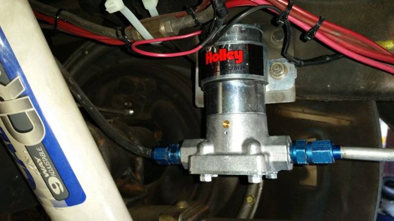

This was the setup on my 66 Coronet that I just sold. I used a Holley Black pump and it worked very well. It even had 5/16" metal line from the pump up to the regulator (not 8AN or 1/2" line)and it worked fine. Powered the 3780lb Coronet to 10.05 ET. It did NOT need big lines and a $600 pump to work fine...just for your information.
