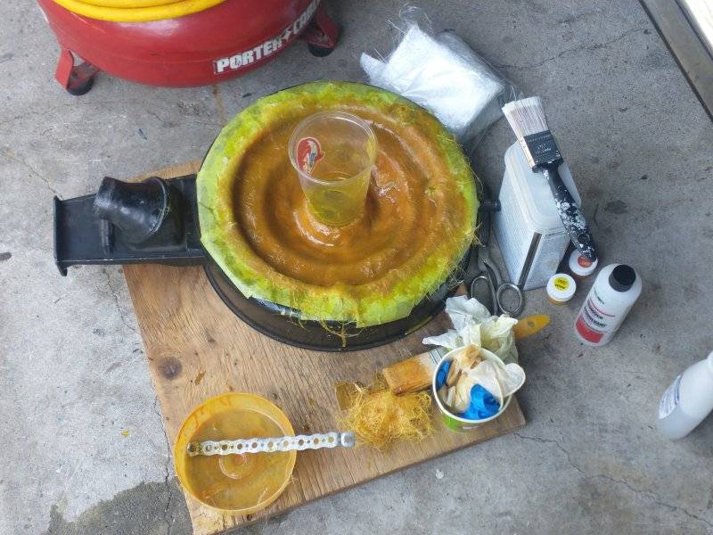

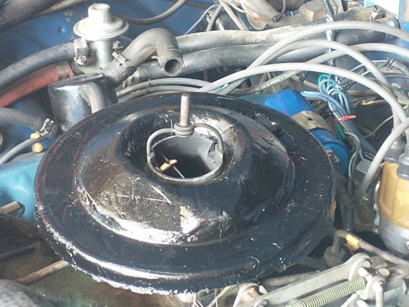

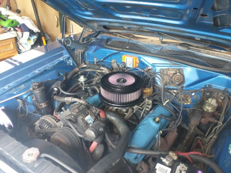

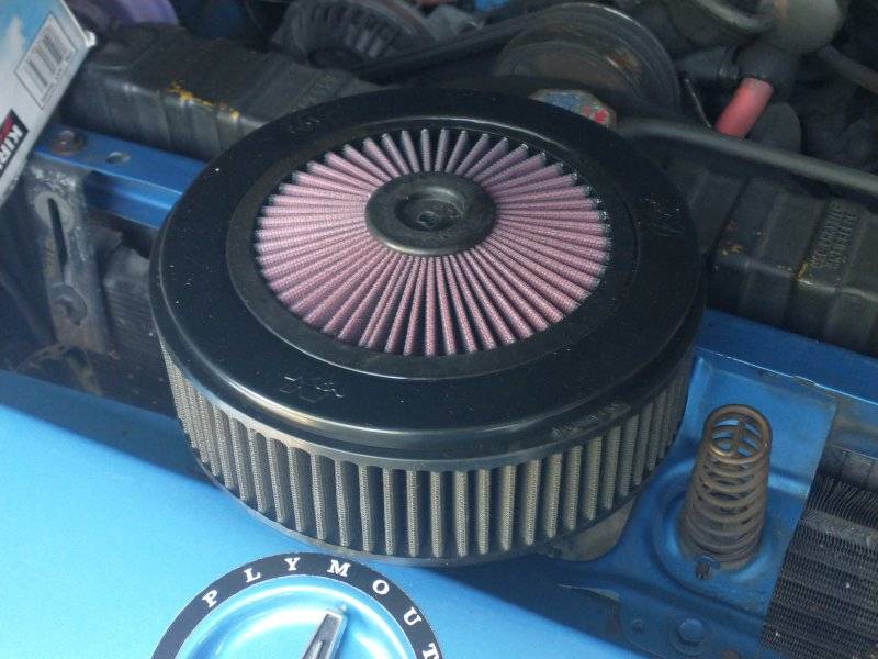

Finally got around to starting the process. I am just waiting for the fibreglass base to cure. Basically getting my feet wet by making a baseplate so I can use my new K&N X-stream filter top. Next up will be working on determining the measurements for a sealable air-box with a flapper.
