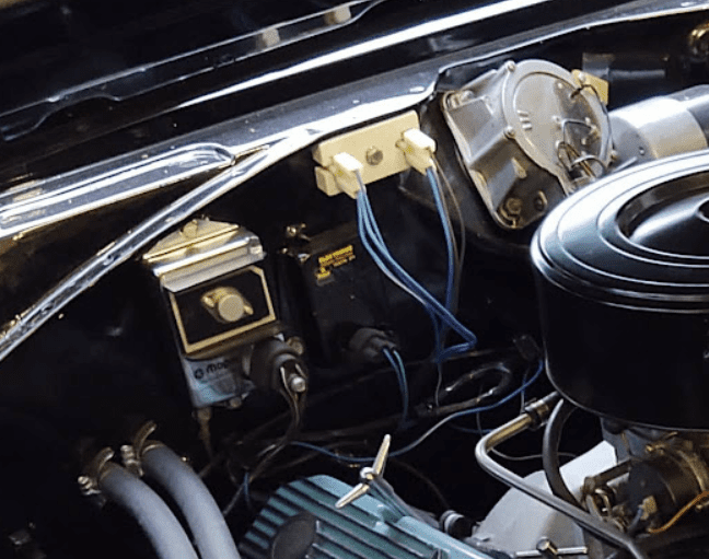

I’ll have to believe you Don. Don’t look like they are connected to me.
Matt B
I think it's done back in the harness not right at the plug (like they used to be)
That picture shows 2 blue wires on bottom left plug. Mine has only 1. Am I missing something?
Matt B
Sorry bad example I think I added a blue one picked off for the electric choke.
My point is you dont see a jumper right on the plug like they used to be back in the day.
Gotcha, thanks. I do have to run power to my electric choke yet.
