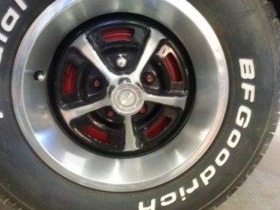

Is it on a nice wheel? If your careful heat the lug nut up with a torch. Get at least part of the nut red.

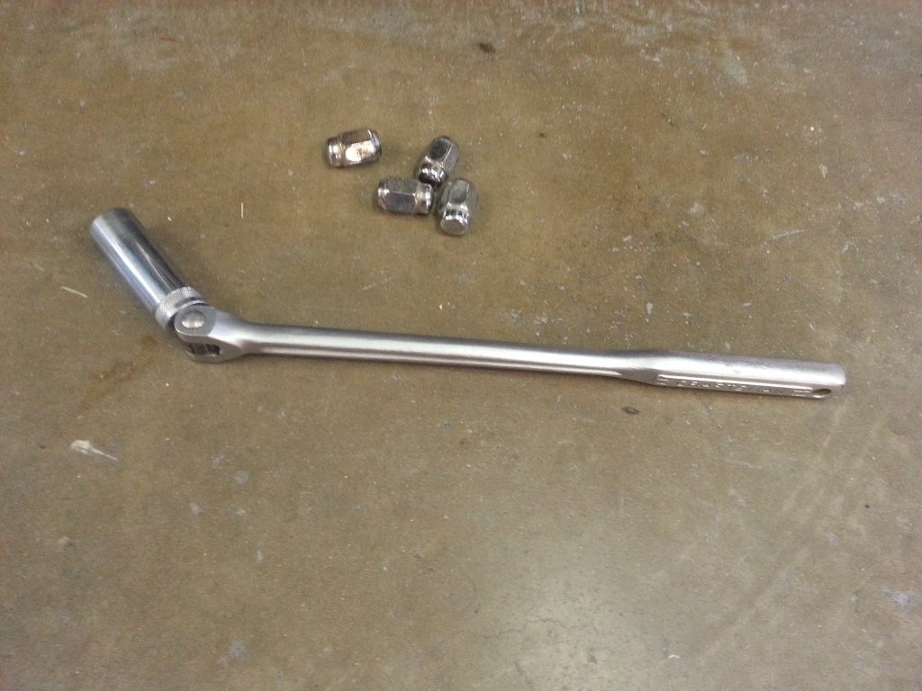

Pics attached. I guess it won't hurt to soak it?

Like 65-440 said, get a bigger bar. The wrench you have a picture of isn't going to move it. Left or right, regardless, a bigger bar will snap the stud in either direction. You need a jack handle on that thing.
Yea, and use a shorter 6 point socket if you can get one on there.
