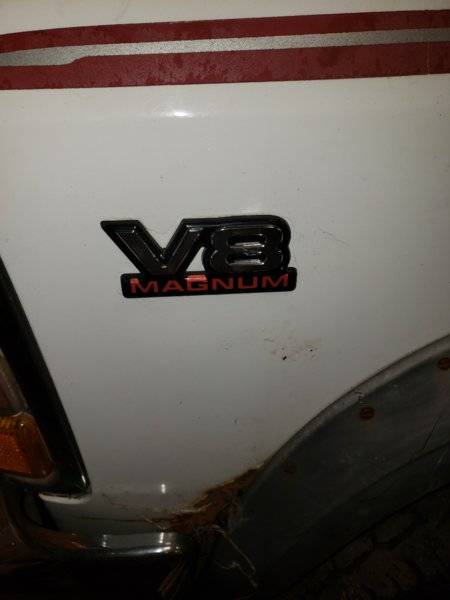

Parting truck out.
Wish too remove in w/o damage.
There are no studs, glued on I assume.
Any tips or tricks?
hair dryer and scraper
Fishing line to remove emblem , stretch between both hands , wrap around fingers if needed , use sawing motion with fishing line behind emblem
5 minute job with those small emblems
The leftover residue on the paint usually takes the most time , but it sounds like you just want the emblems anyways
I’m pretty sure someone posted a thread about the very same thing yesterday. I de badged my 2018 ram after I got it. Used a heat gun to warm it up so the emblem was “movable” THEN used dental floss to get in behind and used a sawing motion with it. Also helps to have a second person to hold the heat gun on it while doing it. Can get most of the glue off by peeling it by hand, then I used an eraser wheel to get the left over residue
Wd40 as a lube then a thin putty knife working it downwards gently tape the blade so the corners don’t gouge the paint
If,you don’t care about the paint just use a scraper and some heat.
Heat or floss. Then wax and grease remover
