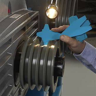

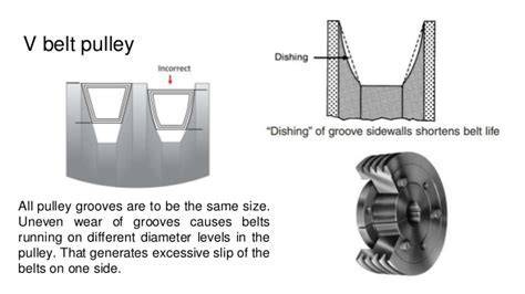

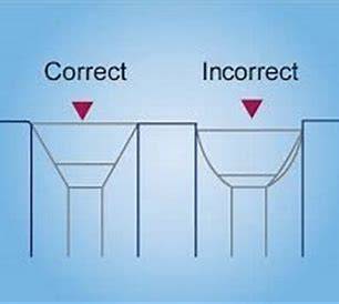

Your pulley(s) may be worn. There are gauges one can use to check the wear. Most belt slippage occurs when the side of the pulley get rounded.
Ron
Ron
View attachment 956826View attachment 956827View attachment 956828
Add this problem in with bad alignment and poor quality belts and you'll always have squeal. In the early 90's when I worked at a NAPA store, NAPA changed their belt types giving you two choices. Higher dollar ribbed type with less cord reinforcement or lower dollar solid with more cord reinforcement. I had a problem on my 70 Chally with squeal and rubber powder all over the engine department. The two tech's at the repair shop next to work told me it was due to the ribbed belts. The lower dollar ones didn't shred rubber like the ribbed. Tie that in with getting the accessories all aligned, which I had done when the engine was out to paint the engine bay. I took a bunch of time to shim/move/tweek the accessories when it was on the stand. Accessories could be ahead or behind the crank, have a twist to them, be bent looking out or in etc etc. Add worn pulleys like the picture that Ronnman shows and you have your problem.
