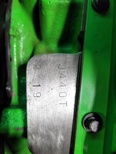

Hello everyone, Hope you all had a good 4th of July.
I have looked for what a letter means on my sons 440 front pad.
I don't know what the T stands for, what it means. I have attached a picture for your review.

My understanding is that (for a 73) the "T" means it's a truck motor.
Later engines I.E. 74-5-6-7-8 the letters started 4T, 5T, etc. where the "J" is located on yours...... In those engines, the "T" indicates Trenton plant.
Thanks for the quick response Lefty71, where can I find that info so I can find out the difference in a truck motor.
Unfortunately i dont know the details. Probably need the factory parts book for a given year to break it down. I think the truck designation only means the medium duty trucks, but i cant be sure. It could mean torque cam, heavy con rods (6-pack) different crank, balancer and on and on.
