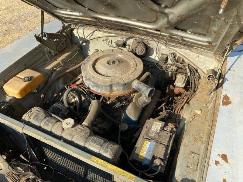

Search the web.. This is supposed to be an untouched survivor car. But looks to be a 383 car.

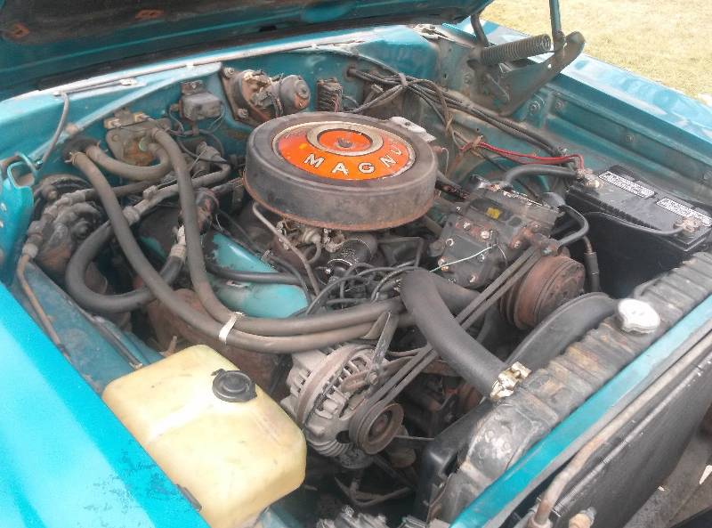

Here is another untouched survivor. Other than the heater core hose bypass.

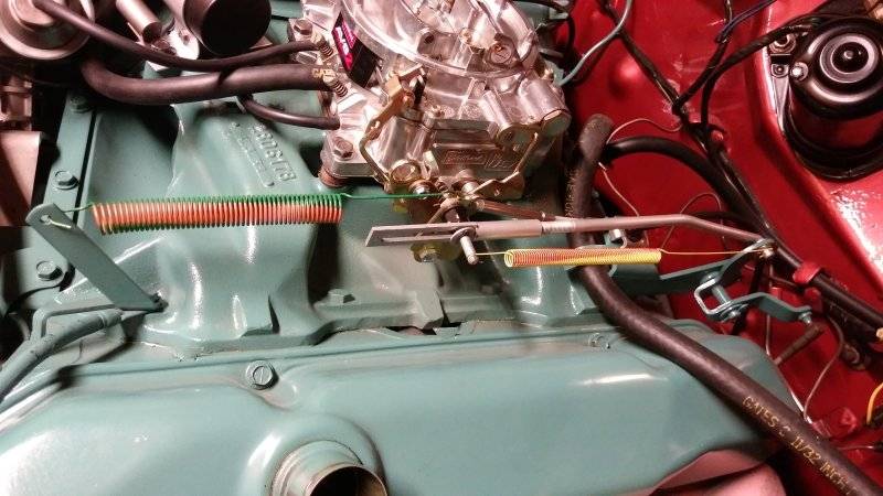

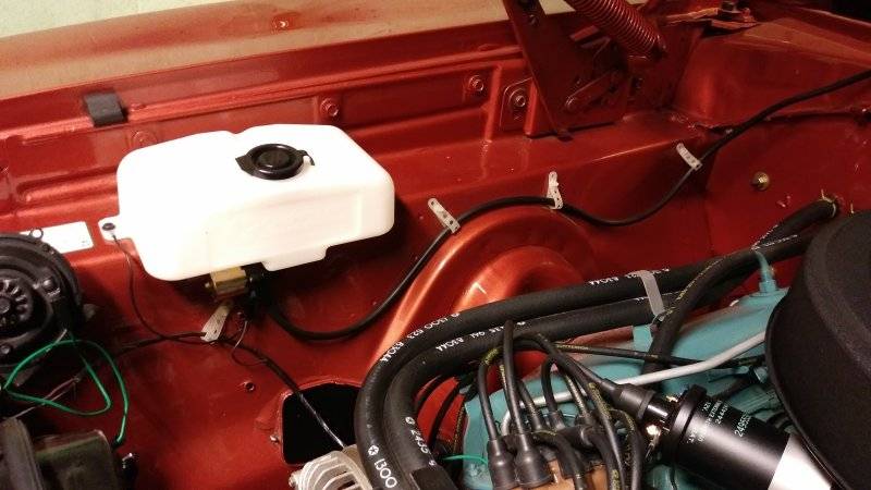

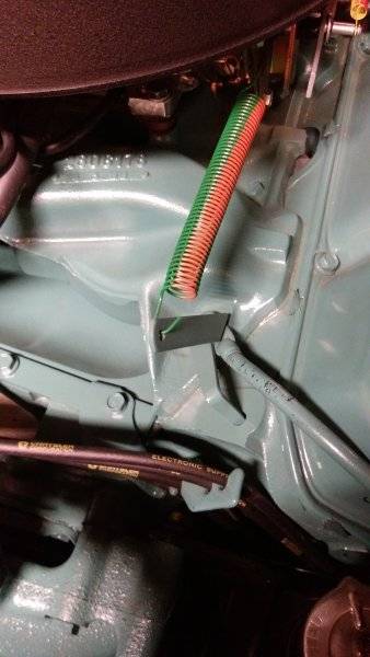

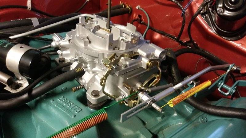

Neg cable end, as well as return spring bracket and intake surface were bare metal prior to painting engine to provide good ground and gets sandwiched between the two. AVS2 is only used for cruising/local shows, but the original restored 4429S is basically identical.
Does the kickdown spring going into the hole at the rear of the kickdown rod? Someone installed a clip in that hole instead of the spring.
Yes the spring hooks into the hole in the rod.
