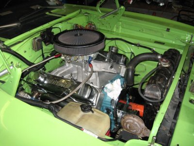

I guess I should update now that this is seeing so much renewed traction (hopefully it helps others with similar questions). I decided to stick the numbers 383 under the bench and sourced a 400 engine for the stroker build. I went with the 440 Source 470 stroker kit and am running the 906 heads, Edelbrock RPM intake, holley 750, headers, pertronix ignitor III for now. I am very pleased with the results, even with a smaller cam (Comp XE268H, .477/480 lift and 268/280 duration). My build may need to go through more phases than originally hoped and right now I'm weighing pros/cons of where to go next; efi, cam, rockers, heads, etc.
Currently my thought is to get a 3.73 rear and do rockers (might do a 1.6 ratio to help the 470 breath with the current cam for now). Feel free to weigh in on opinions, I'm always open to listening to the knowledge of others!
