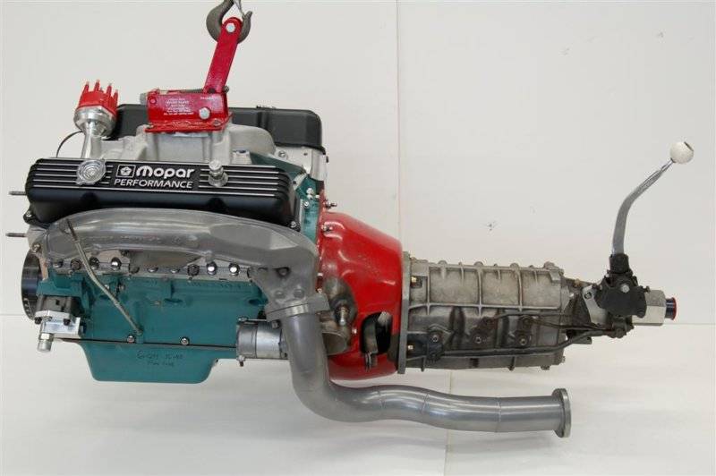

^^ Agree with Andy. If you're going stroker - the 4.25/chevy pin combo is where I'd be. I might go a little over the 10:1 but that's me. Ported Stealths will feed it fine. I'd either go flat tappet solid, or solid roller with lifter bore bushings. IMO there's no value in the initial expense of hydraulic roller. Either way a custom cam will work fine with your manifolds.
