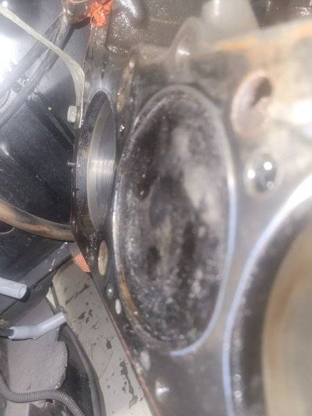

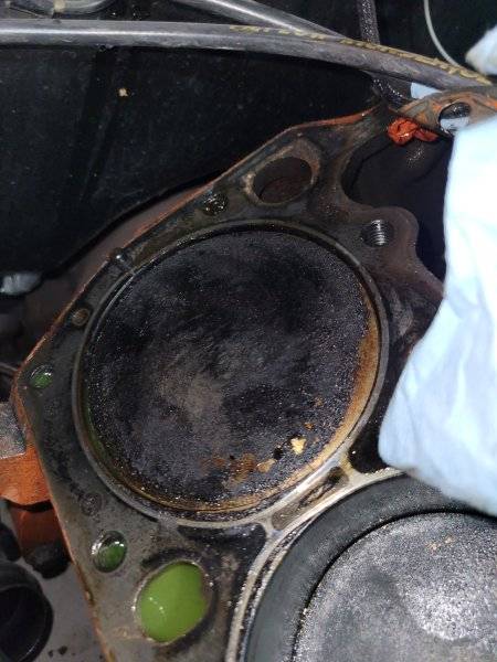

So I am looking to add some power to my 69 440 and could use some help. The engine has about 1000 miles on it and it didn't exactly have the kick I was hoping for.
It's a stock 440 with a Holley 670 and Edelbrock performer 440 manifold.
I took off the iron 906 heads to check things out and to my surprise the short block wasn't what I told it was. I was told this engine had forged Ross pistons, and the block was decked. The pistons clearly are stock flat tops with no valve reliefs. Bummer. It also doesn't look like the block was decked since the piston doesn't go to the top of the deck. Compression test was all around 160-170.

Below are photos of the pistons.
You should get 450 HP easy. I just built a 400 stroked to 512 with 452 heads slightly ported, 220 duration .525 lift hydraulic roller cam, fitech fuel injection, it made 500HP 538 ft lbs, and idles at 16 inches of vacuum on pump gas. Do not use a flat tappet camshaft spend the extra money for a hydraulic roller, more lift with less duration will give you tons of torque, and still idle pretty. Only issue I see is with a bigger cam you may have piston to valve clearance issues. Not sure how experienced you are, but a good engine computer program will tell you if whatever combination is right. I use performance trends, and if you put good info in the program, it gives good numbers. Have built scores of engines on the program, and on a real dyno within 10% almost all the time.

With a feeler gauge pistons appear to be about .055- .060 in the hole. I don't have a dial indicator.
Will hopefully by this weekend, have it fully torn apart.
Perfect it sounds like stock pistons. The good ones.
