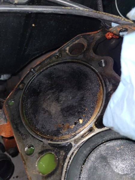

I took off the iron 906 heads to check things out and to my surprise the short block wasn't what I told it was. I was told this engine had forged Ross pistons, and the block was decked. The pistons clearly are stock flat tops with no valve reliefs. Bummer. It also doesn't look like the block was decked since the piston doesn't go to the top of the deck. Compression test was all around 160-170.

Below are photos of the pistons.
That's why i don't believe ads stating : forged rotating assembly, arias/ ross etc pistons. Better just to tear it down rather than take anybody's word for it, unless they are reputable like some on this site. Good luck with your 440 build.

@diesel_lv. My thoughts exactly. I didn't like seeing that. I don't know what upset me more, seeing the flat tops or the carbon lol. Made me think that there are a lot more miles on this engine than what I was told. Also, Oil pressure is about 40lbs hot and about 60psi on the freeway.
Clean off the crud at the top and check for ring ridge.
What year is cast into the block and how far down in the hole are the pistons? If it is a motor home engine I suspect the c.r. will be low. Hughes Whiplash cam HUG SMC3245BL for low compression engine is what I would look at if you don't want to swap out pistons.
Need to know how far the pistons are down in the hole, as that matters a lot for the cam etc., what's the piston to deck? Got a dial indicator and some feeler gauges?

those pistons don’t look like the super low compression ones. The 7.8 to 1 stuff has the piston to about a quarter inch down the hole.
I will check to see how far down in the hole the pistons are. I can still see some cross hatch in the cylinders so I guess that's a positive. Here are some more photos. I'm assuming the black line at the top of the cylinders is oil leaking from the valve stem seals?

I will be pulling the engine, I just checked the engine casting date and it is a 68 Block. When I have the engine out of my car I will check to see how far down in the hole the pistons are.
Without going anywhere else... anywhere... you have to know exactly what you got with your current reciprocating assembly. That's where you start, then go from there. See posts #11 & #13, that's exactly what you should do.
The compression test of 160-170 psi in all cylinders is good, with 906 heads that would make the compression ratio approximately 9.7 to 1
