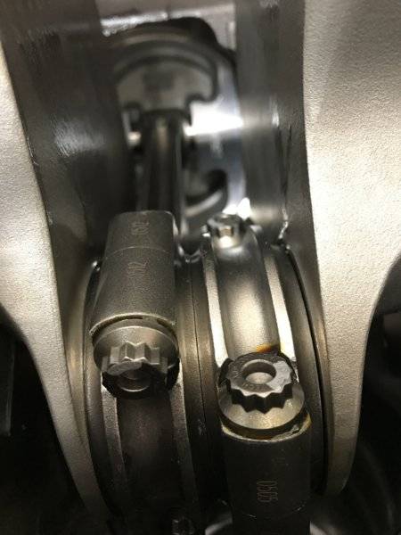

engine builder screwed up. Maybe not. Update

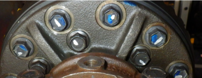

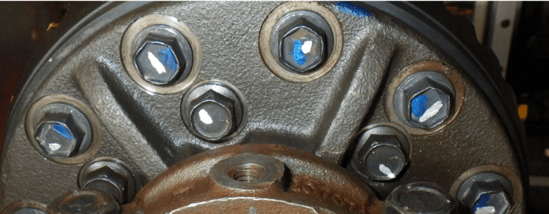

I started marking bolts torqued so I don't inadvertently miss one...…….. or more!

Hope all is well with the rod, put her back together and let her roll !
Yes this issue has brought planes down! I had a thread up on this a few weeks ago about the promise in grade school on the imminent conversion promise never delivered. Its frustrating but you'll be fine real soon! At least a rod didn’t fly off! Are you going to check that rod bearing on that wet cylinder?
I don't blame the Cometic's at all. This set was new. The last set was reused 3 times. The pitted surface along with lack of torque is my bet. Personally I've used Cometic's that looked worse than these again. Just to lazy to do it twice if it did have an issue. Pulled the piston and rod. Looks good I'll fixture check the rod tomorrow.

Good it wasn't something catastrophic

Did you do this? You're good. The guy who built this Mercedes diesel must have had a bad day and left number 5 rod bolt loose. Gave me and my customer a really bad week. That engine had 83 miles on it when the rod windowed the block and snapped the starter off.
Man, that had to do some knocking before it came apart.....?
