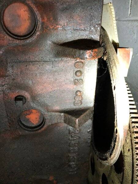

Here is a 383 I have sitting in the corner. June 2, 69 casting with the 70 "E" code stamped on the engine ID boss.
thats normal, blocks are cast way ahead of building.
