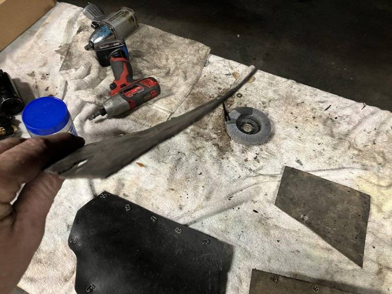

Can anyone please tell me or send me some pictures of the engine compartment covers that are installed in the aft position. I have the forward ones that are made of steel. But I don’t have the back ones and have no idea what they look like or what they are made of. Thanks
The rear ones are a fibrous type of material similar in thickness to roofing paper.
The rear ones are.. ummm.. rubber...

Road Runner....
Yeah, I don't recall what the material is called but it isn't rubber. The ones I have are a stiff and grainy mat.
They are held in place by unique pins.
Maybe some were rubber but mine seem to be different. Mine are about 1/16” thick.
Dodge trucks used similar material.
I've seen both, but my OE's are rubber off the Bee and Bird. Crusty, oil soaked, heat baked and easily cracked, but it's rubber.
They do look the same. Maybe some mix of rubber and fibers. I never knew exactly what they were. I know of nowhere else that this material is used except as flexible covers.

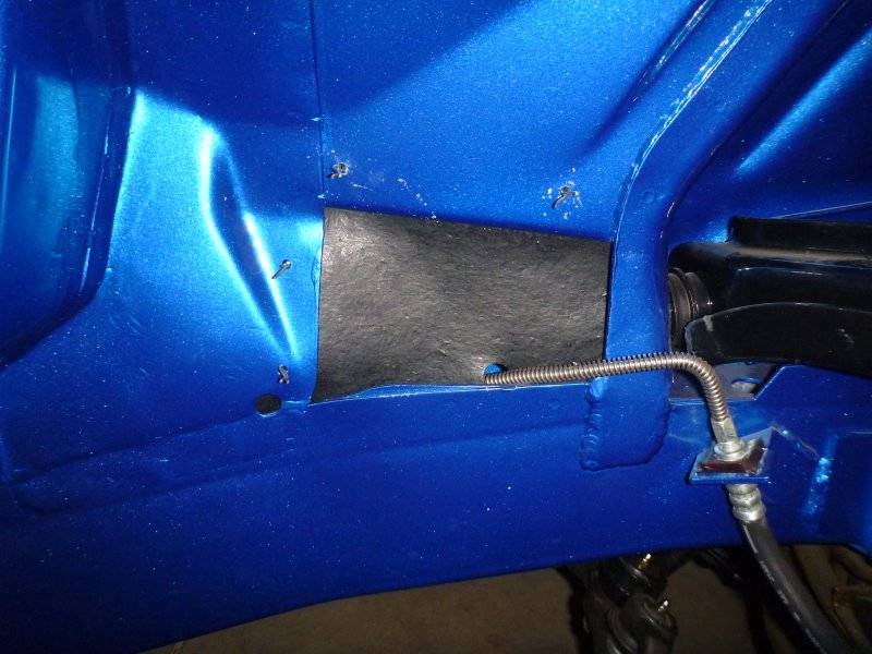

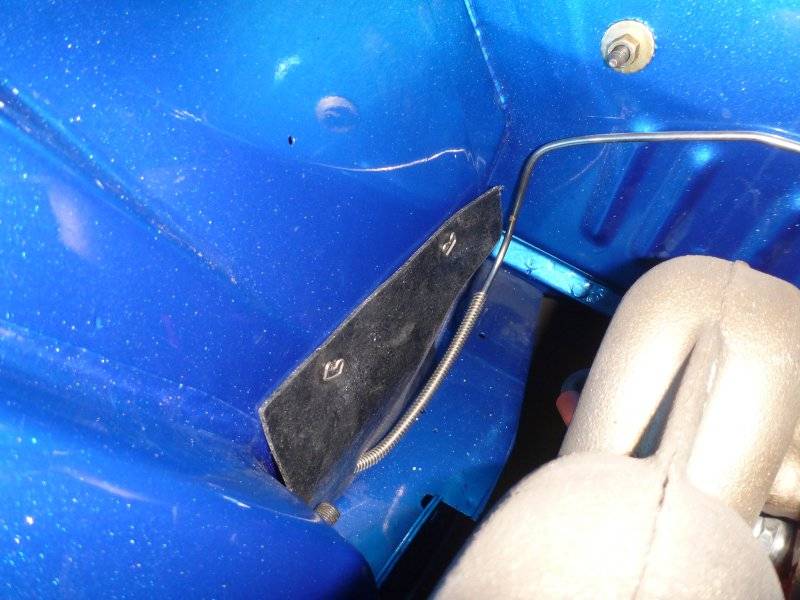

Once again, Dad to the rescue. I wasn't worried about the covers but the brake line routing on the passenger side answered a question that I encountered today. Thanks Dad.

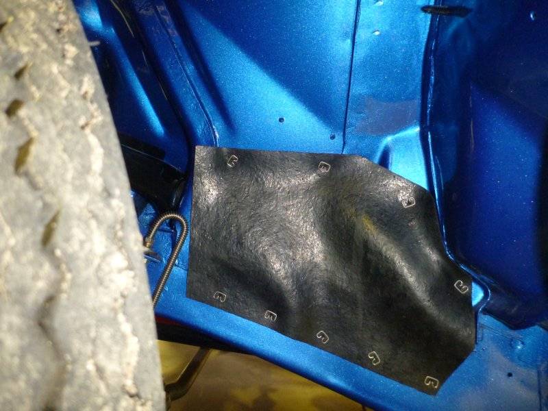

Just a question but shouldn't the rubber shield be installed from the wheel side on both?
I put both mine on the outside, just because I think they look/work better that way. But, Wayne has proven years ago, that the one side came from the factory on the inside.
Mine were originally installed on the outside on my ‘69, which makes more sense in regards to performing an alignment.

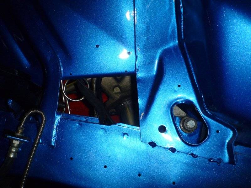

If we get our power and internet back...90k winds here.. I'll post a little video I just took of an OE cover. As for inside or outside. Outside would have made a lot more sense IF they had of put mounting holes in the frame rail like the drivers side.
Both my ‘69 Super Bee and Charger were on the outside and look to have been from day 1. Low mile vehicles, unmolested, owned since ‘81 & ‘85 respectively.
69 and 70 Lynch Road cars, both on inside. I've known where the Bee has been since I was 7 years old..
