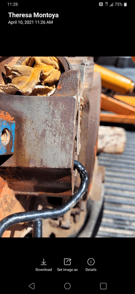

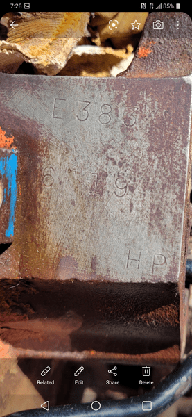

Just picked this motor up from a storage sale. 1969 383 hp complete from intake to oil pan, clean inside and turns over nice for 200.00. Any help on numbers? Thsnks

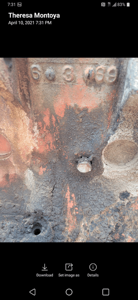

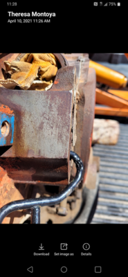

Came out of something that was made in Los Angeles, CA. E383 is '69, can read the HP but your picture is too small to read the date of assembly...
Assembly date looks like 6 19 to me

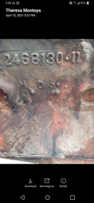

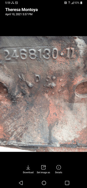

Your picture is the cast date of the block.

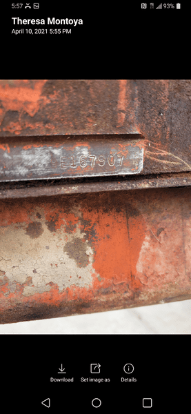

You only have the serial number, you would need the letters prior to the plant to tell what car it was from.
Those are the only numbers on the pad above the oil pan. Would they be somewhere else?
All you can determine from those numbers is it came from a 69 car. It's a HP engine therefore only about two possibilities. 69 Superbee, or 69 RR.
this is the pad above the oil pan I was asking about. Should there be more numbers in front of this?
For a short time in early 1969 model run, the full vin was stamped there. By about January 69, all they put there was year, plant, and six numbers of the vin, 9Exxxxxx. As above said, all you can tell is L.A. built 383 hp, unless you can somehow trace the six digits of the vin.
