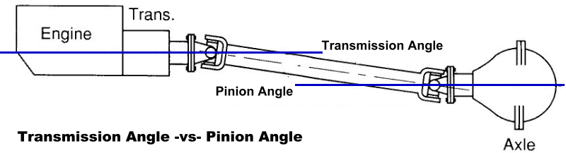

The short answer on pinion to transmission angle is that under full acceleration, with normal car loading, you want the pinion and the transmission centerline parallel. This implies, that at rest, the pinion should point a little bit downwards in relation to the transmission shaft centerline, 2 1/2 degrees (at rest) is a popular bandied about figure.
Google pinion angle, but keep this in mind: Guys get all "complicated" but the simple equation is the relation of the pinion shaft to the transmission shaft, PERIOD.
Below is simplest I know how to make it. "Under acceleration" both shafts are parallel
Pretty much what 440 Roadrunner has said but I'd add that the pinion pointed down 2 1/2 degrees isn't always true. I fought with mine for a while and didn't eliminate the vibration until I matched the angles.

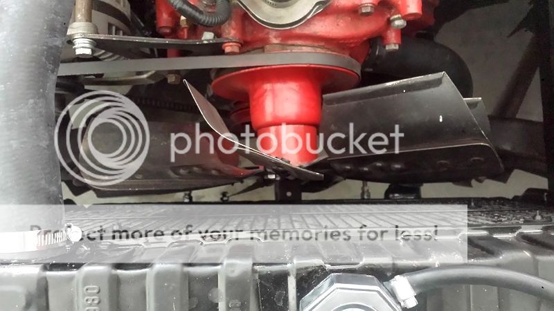

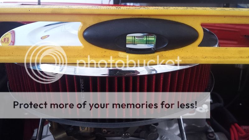

I placed a level on top of the air cleaner, looks to be level with the ground but when you look down at it from the top and compare it to the radiator, it does seem off. My friend pointed out that you can get 2 fingers between the blade and radiator on the top and 1 finger at the bottom.
