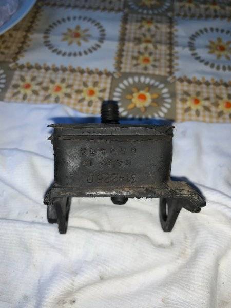

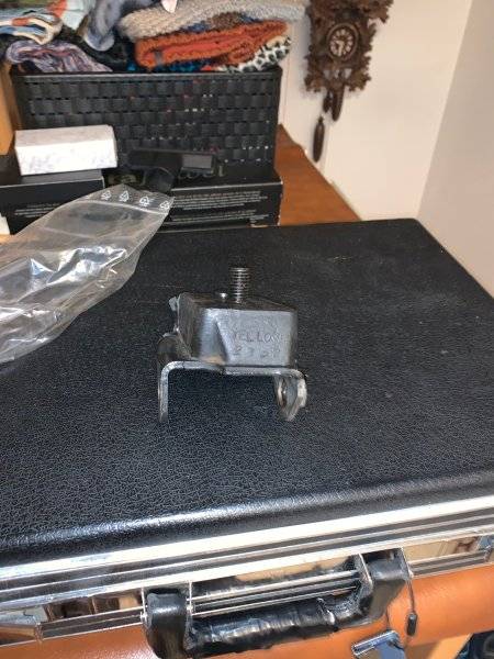

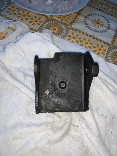

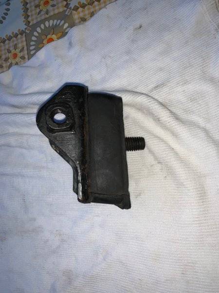

I attached some pictures of the old mounts. They do not really look broken.
What i noticed is they seem pretty new and according to what's printed on them i think they are 2 different mounts/brands.
One says "made in canada" which i assume means "not original".
Driver Side:
Passenger Side:

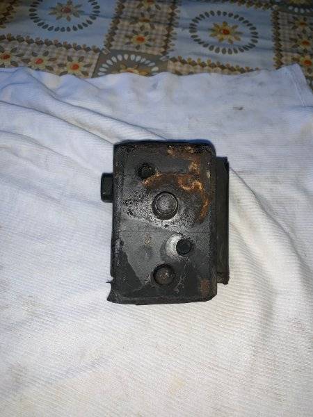

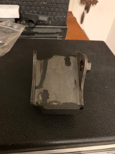

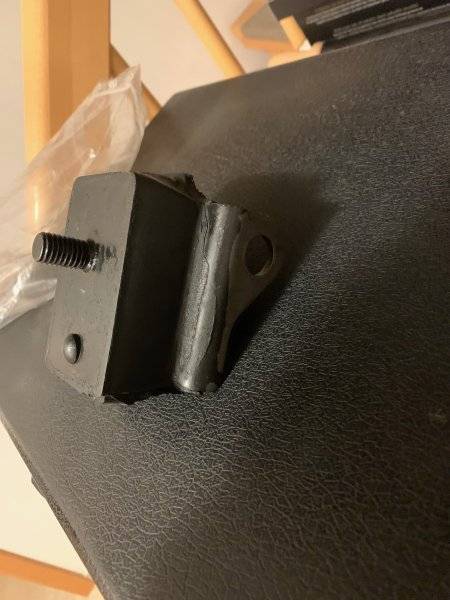

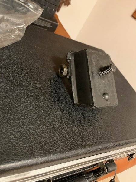

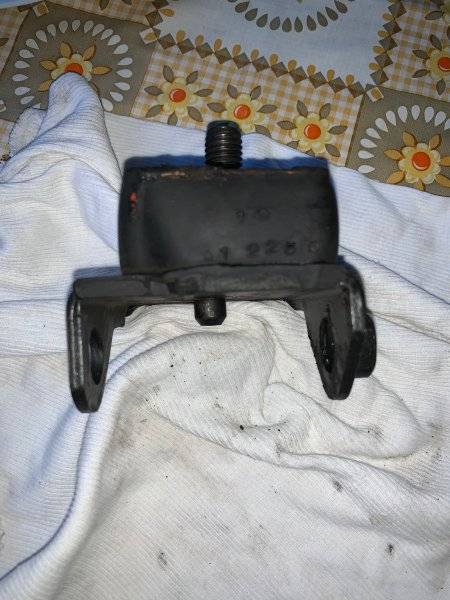

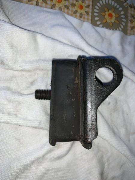

Chapter 2: It maybe wasn't even worth it.
Driver Side:
View attachment 1306483View attachment 1306484View attachment 1306485View attachment 1306486View attachment 1306487View attachment 1306488
Passenger Side:
View attachment 1306490View attachment 1306493View attachment 1306494View attachment 1306495
With the new mounts in we checked again with braking while giving some throttle and/or changing gears and it seems
that the engine is moving noticeably less. (It's not that it's not moving at all but i think it's somewhat less)
It actually feels like instead of just the engine moving the whole car moves a bit when changing gears. (Park to Drive)
This would be a good thing. But again the old mounts do not really look bad at all from a visual inspection.
But maybe the rubber is to soft? I don't know.
